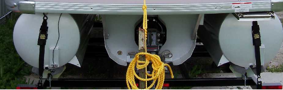

I always strap mine down (see pic). Notice on the starboard side that my strap actually lays right on the mount.
I have never seen one come one off the trailer first hand, but when someone in the future asks if they have ever had an issue, I don't want to be the guy they are referring to when they say, "No, but I once saw a guy with a pontoon that...".
Note, the yellow line in the middle of the picture is because I had a temporary fly covering the boat before I got my barn built, and I needed to keep the fly from blowing away.

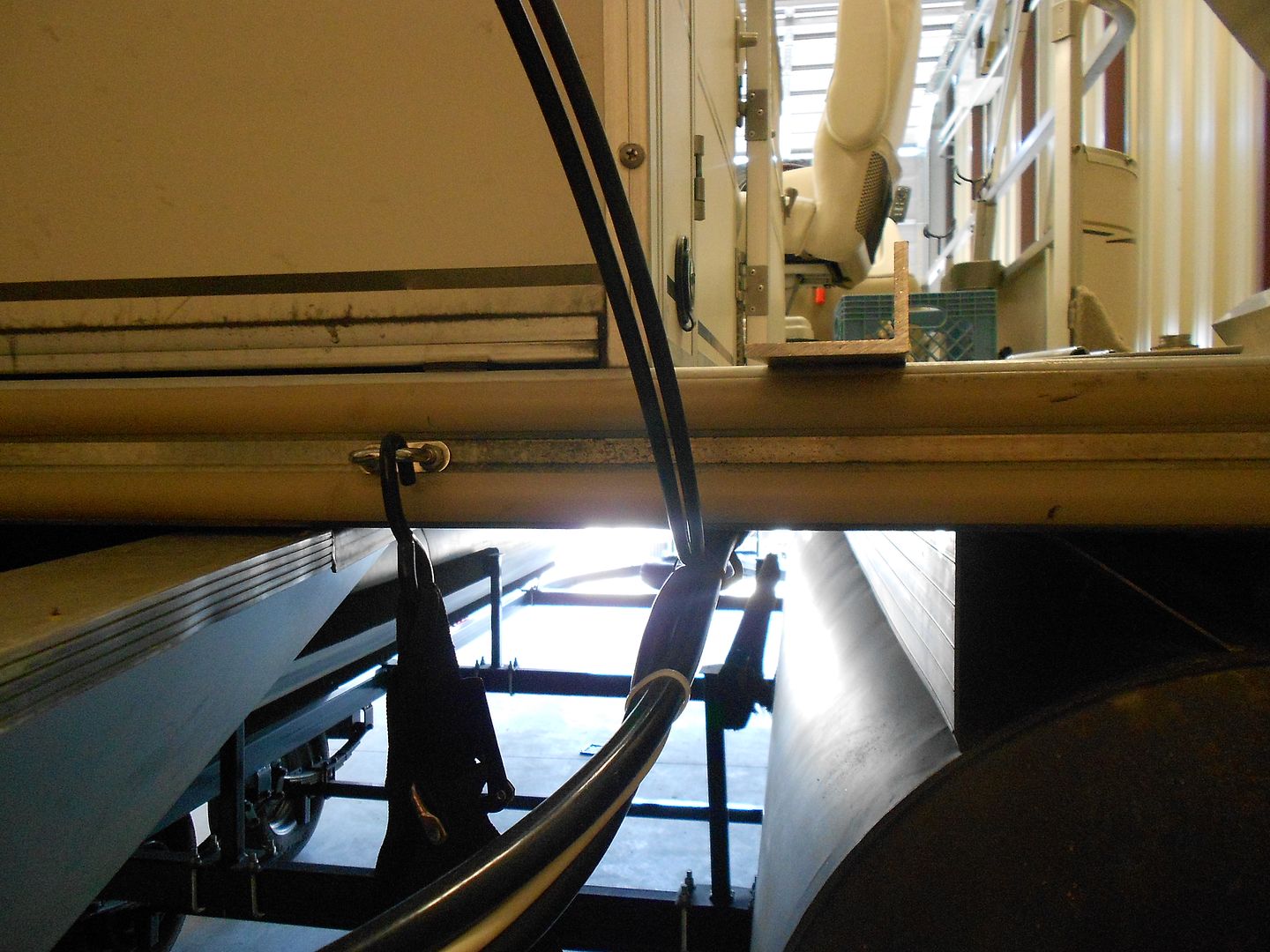

When I did this to my trailer bunks, I decided the short trip to the lake ramp was too hilly to not tie down the rear. This stuff is just to damn slippery! I do it all the time now, not just on long trips where I tie four corners.
I added stainless steel 3/8" eye bolts to the ends of four conveniently placed channel aluminum frame members. I tie to these eye bolts and to the trailer frame.
