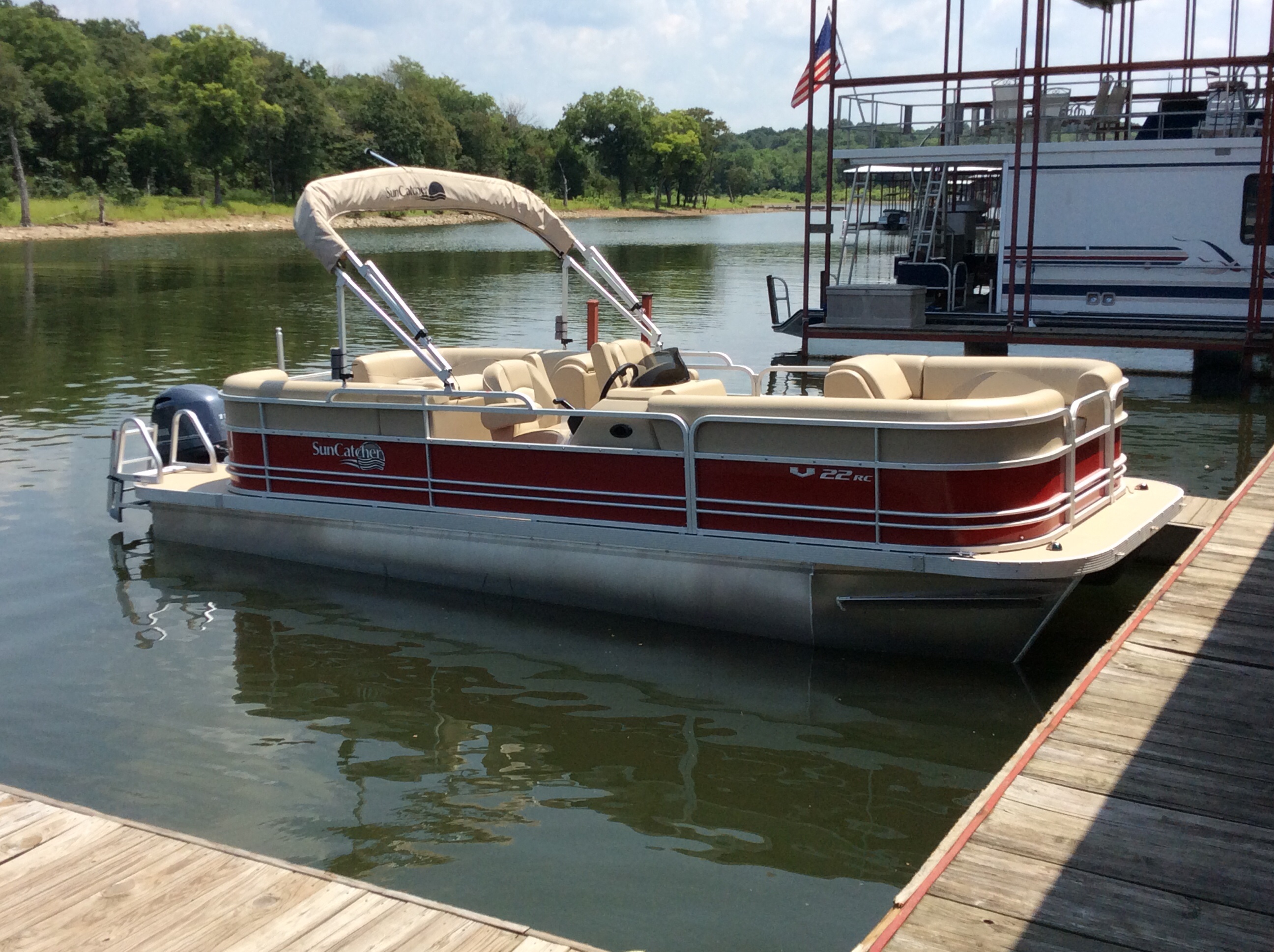

I have a whole new plan...gonna trade this POS off...yea I know.lol. The marina is a g3 dealer and has a new 22 ft with a 115 Yamahamer on it. Really nice boat. Took it out for awhile this morning. Wow, what a difference! I think I got the wife on board . Don't owe any money on it so maybe I can make all this go away with swift handshake.

We'll fellas, I solved that problem. Traded that piece of shit off today for a brand
New 2014 22 ft G3 Sunchaser with a 115 Yamaha. Whoo hoo!!!!! I don't screw around with things that don't run, especially a damned boat. After all the problems, there is no way I would ever trust that damned motor again. Plus this one is plush , mushy and will run almost 40 m.p.h.. With no problems.
Agreed to sell my Harley to pay for most of the trade difference limiting the amount out of my pocket to about 3500.00. I'm 53 yrs old and have been thinking about getting off of the bike for about 6 months now. I've cheated the reaper for 35 years without getting hurt on one. Figure it's time to hang up the helmet while I still can plus the money goes for something the whole family can and does enjoy so it's win win for all of us....
It will be in my slip on Saturday after the marina folks prep it out and my wife and daughter decide which color they want...red , blue or black....I'm just happy to get rid of that piece of shit Mercury. Never again.

#21 Post by Soonertoon » Wed Aug 06, 2014 6:43 am
I took one out on Sunday for a little test drive...same boat , same motor. Speedo stops at 35m.p.h. Buried the needle. The marina /dealer is getting a GPS/mapping unit set up on it for me so I will compare to see exactly how much over the 35 I can get. I was realy surprised at how fast it was. Stainless prop . dont know the pitch etc. Im sure there's more speed to be had with learning the trim sweet spot and a possible prop change.
All I can tell you is that I really am going to love this boat. This pontoon is only the 2nd thing with a motor on it, that I have ever bought brand new. Cars, trucks, motorcycles...always bought slighly used and saved the money as compared to new. No need to go over the financial impact/benefit of that but lets just say it works. However, with the boat Im not taking anymore chances . Got a workable cash deal and everyone wins and I owe nobody for it when its done .
