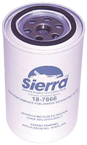

With modern fuel injected engines and a tight fuel system you shouldn't have an issue. That being said my fuel lines are SAE J30R9 and I use Stabil Marine/Ethanol treatment along with this bad boy:
http://www.amazon.com/gp/product/B000N9 ... UTF8&psc=1
Of course if moisture gets in a bad seal the filter cannot fix that.
