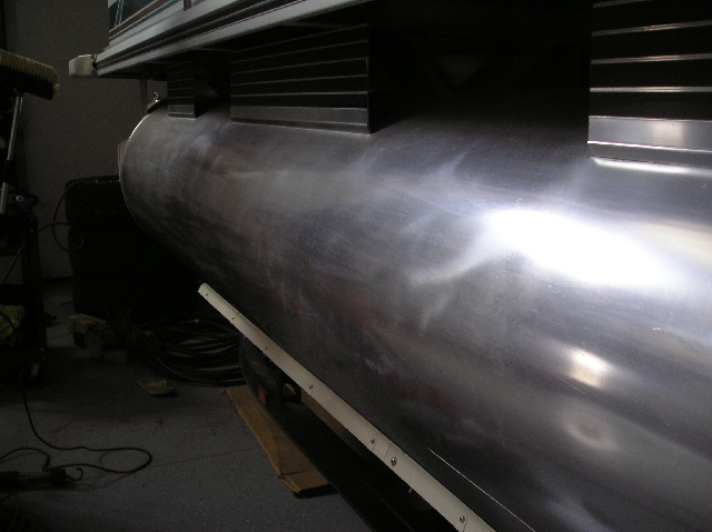

I know this one gets done to death :deadhorse so why the hell not add to it again. If you can tell from the pic from the last time I polished with a synthetic pad and Flitz I was left with BAD swirls. It looks even duller with Shark Hide over it. I had planned on just using lacquer thinner to take off the Shark Hide and re-polish with a wool pad with my Makita and a more abrasive polish like Mothers or Meguiars over the top of the Flitz. If I should remove the Flitz I still have a lot of Eagle One aluminum wheel etching cleaner. It seemed to work and smell like any thing else I've used for cleaning in the past. If I remember I think the people from Flitz told me to use it. I know I've seen a lot of pics of toons here that looked like chrome. I achieved that look the first time I polished them in '04 but haven't been able to find the same polish since. Any input would be appreciated.

Surprised the flitz caused swirl marks. Think I would use the meguairs or mothers and finish with the flitz. Are the pad free of dirt an grime? Never really had any problem with the swirls. Might try a little slower speed. Think my buffer had about 7 speeds an I usually used the 2.5 to 3.5 setting. I used the microfiber pads (blue ones)from auto zone.
From where you have them now, I would use the mothers power metal or meguiars. They cut better and now I believe the info on sharkhide and flitz about being non abrasive after trying to remove a few blems, I had overlooked on my last polishing.
Hard to beat the sharkhide or flitz on bring the shine quickly, but also highlights the blems you didn't even know you had.

dockholiday wrote:Surprised the flitz caused swirl marks. Think I would use the meguairs or mothers and finish with the flitz. Are the pad free of dirt an grime? Never really had any problem with the swirls. Might try a little slower speed. Think my buffer had about 7 speeds an I usually used the 2.5 to 3.5 setting. I used the microfiber pads (blue ones)from auto zone.
doc
Hey thanks Doc. I really want to get those things back to looking like chrome again. I'll check out the blue pads too.
