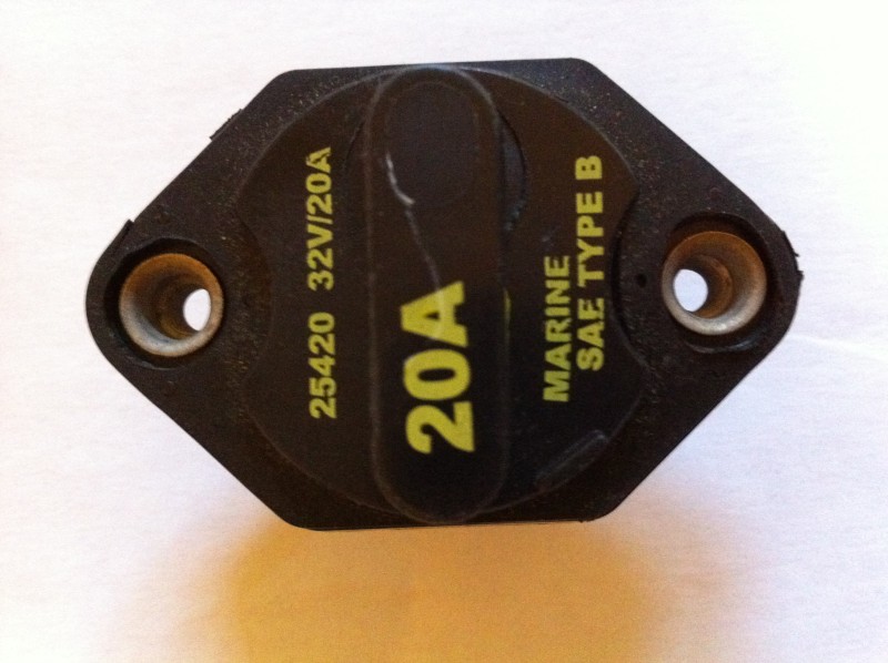

I've attached a photo of the fuse, but I have a couple questions:
1. How can I determine if it is blown?
2. If blown, do I just replace whole unit?
3. If I have to take apart, how?
- 20 Amp Fuse at Battery
- photo.JPG (87.49 KiB) Viewed 1642 times

A little research with google and it appears to be a breaker and not a fuse. There is a little yellow piece that swings out and appears to have the word "Reset" on it.
I can only assume that if it was tripped, then the yellow piece would be swung out and to reset I would just push back in.
So, without any more details, it appears this breaker isn't tripped and is fine.
Does that sound correct?

Solved and man that was a bit embarrassing. Once I charged the cranking battery, I must have connected it incorrectly, because when I reconnected the 20 amp and then tried the battery again it worked!
I know the breaker wasn’t tripped, so it must have been a stupid mistake when connecting the battery.
Sorry for the trouble.

wolverine97 wrote:Solved and man that was a bit embarrassing. Once I charged the cranking battery, I must have connected it incorrectly, because when I reconnected the 20 amp and then tried the battery again it worked!
I was just getting ready to say.... you have the accessory wires crossed on the battery, or both hooked to one post. This is a relatively easy mistake to make, and prevent.
Don't ask me how I know you had them switched....
