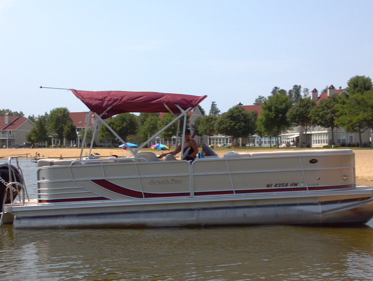

#12 Post by smoker62 » Wed Apr 03, 2013 5:07 pm
Love mine as well. I did have a couple minor issues. First , my cover came apart at the collars for the bimini uprights. Just a bad sew job. No rips or tears , the thread just came apart. 3 out of 4 last summer.
Also I will have to cut my back bimini supports and make them shorter. The top just does not fit right even with the front uprights in the lowest holes. It sits with the front too low and the top is somewhat loose. Only way I can see is to raise the front and take the slack up by lowering the rear.

#13 Post by redbeard » Fri Apr 05, 2013 1:42 pm
It looks like your front posts are shorter than the back ones move then end for end front to back and back to front. Could work maybe before you cut them.

#14 Post by cwag911 » Wed Apr 10, 2013 2:44 am
Smoker, your top just needs to be adjusted.as was said above. Loosen where the front and rear struts attach and you should be able to level it out. That was poor setup from the dealer.

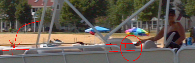

Smoker-
Cutting the rear struts may work, or relocate them backwards onto the main top fence rail.
That elevated fence piece is what got you buggered up.
Nice Southbay btw.
