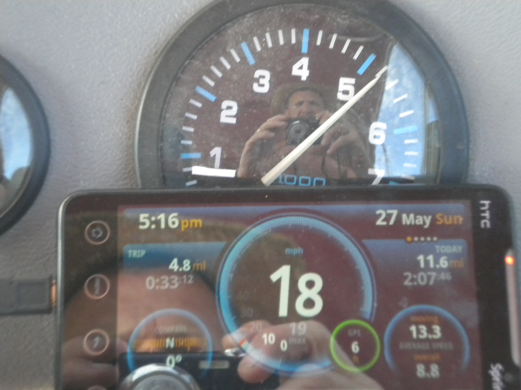

If you have a smart phone there are many apps that can tell you your speed. The one I used is much more accurate than any pitot based speedo. It's called "Ulysse Speedometer".

RonKMiller wrote:If you have a smart phone there are many apps that can tell you your speed. The one I used is much more accurate than any pitot based speedo. It's called "Ulysse Speedometer".
yep it is awesome!!!
- DSCN6285.JPG (199.75 KiB) Viewed 2497 times
