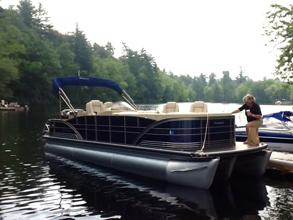

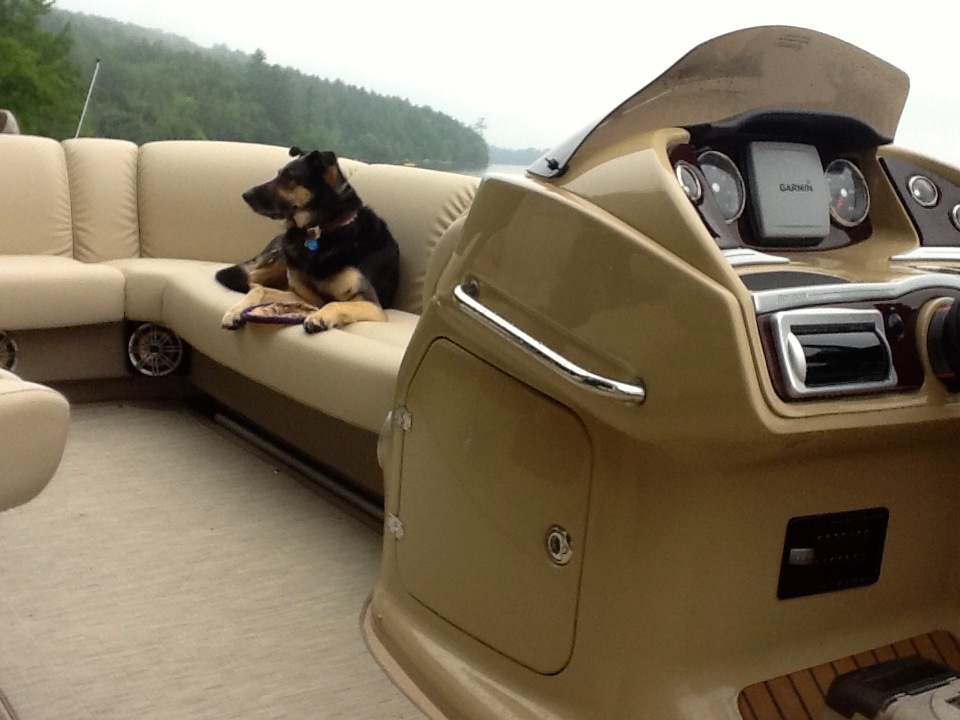

I had to post a couple of photos of the new boat...more to come I'm sure! Looking good on the water!

Hold on a sec.... Lets review, You got a brand new boat with a built in bar and grill and the only two pics posted are of your wife and your dog??? Am I missing something?
Now if the pics were of your wife at the bar and your loyal companion by her feet, then ok, but no pics of the bar and grill, I say FOUL
Help a brother out. We need pics of the party zone so the rest of us poor slobs can dream
