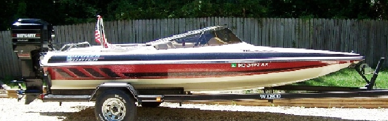

Oh, learning. bought this 1988 hull in 1990, first hung hopped Chrysler 115, After burning too many pistons, went
to a 175XRi in1991. Late upgrades are Bob's machine plate, SeaStar steering, Trophy Plus prop 26P. I just learned how to go 70mph, stone stock Livorsi GPS speedo.
