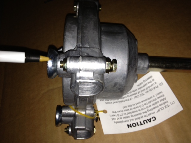

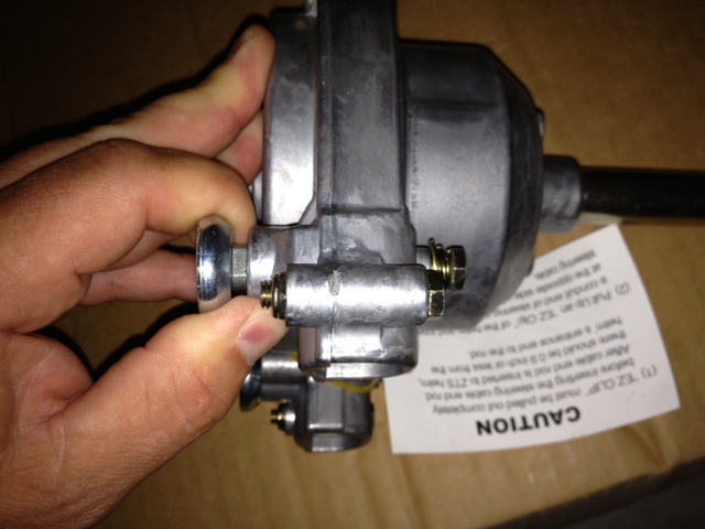

I guarentee you don't need parts for the steering...it's just not seated right. Look at these pictures: In the fist shot you can see the spring loaded pull pin (pen pointer). Directly opposite is the safety locking bolt. To get the cable seated properly you must: A) make sure the bolt is all the way out, B) pull out on the spring loaded pin (photo 2), and C) feed the cable all the way in. This process works best when the opposite end is not hooked to your motor, as some times you need to actually use the leverage from the rotary helm to pull the cable all the way in and get it seated properly. Then make sure you tighten down the safety bolt snug and you're ready to roll...

We done that many times over, we might have got a bad one, that's why we are going to have it looked at to know what the problem is, we might have a cable problem as it jumps out on both sides, we know because the boat guys brother had it rigged wrong when we picked it up and it was kicking out of the wrong side too, I had it rigged right and it wasn't popping out we we sent it to the shop.

Found piece of junk stopping the cable from snapping all the way in, removed it and it snapped right in, then we put windshield on, the other Captains seat and tables put in, moved the water presure line moved to the pisser side, where it should in the first place, so it would show flow and will peg out, if the pisser get clogged again, that's how I knew it was wrong.
