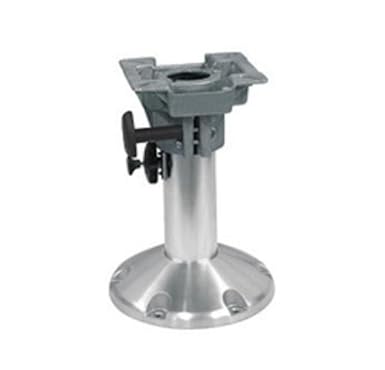

I am not sure what type of pedestal you have, but they do sell different heights and even adjustable ones like this one
http://www.amazon.com/gp/product/B001O0 ... =soca0f-20
-bb

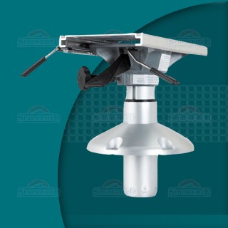

You can buy adjustable ones. The one linked above is an economy model. I bought this one.
http://www.amazon.com/gp/product/B00160 ... UTF8&psc=1
Currently $72.90 at Amazon. I got mine in 2009 and it was the best $70 I ever spent on my boat. My 2001 Bennington's seat was too low and now it's great.

Just slides down on the piston. My Premier has the Springfield Thru deck Mainstay. Its solid as a rock when locked into position, but slides, swivels and adjusts up and down real easily. If you have the same diameter seat base, you can add a non thru deck adjustable pedestal.

#15 Post by rancherlee » Sat Jul 20, 2013 6:22 am
