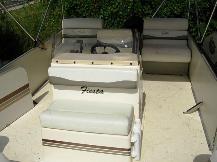

I'm thinking about insulation my livewell and adding a lid so the water doesn't slosh out. I mostly fish with artificials so I don't utilize it for bait often. I would like to use it for keeping the fish iced. It one of those seats with a livewell under it. Anyone else done this conversion?

How about a pic of how it is now? If it is like my old one it had a oval shaped black plastic insert inside of the seat. I would assume you could put some styrofoam around the outside and a cut a groove in a piece of styrofoam to set on the insert for a lid.

When I built my live well I put the blue insulation on the sides and bottom just so I could also toss in a bag or two of ice and use it as a cooler, its worked out fine. Mine isnt used as a seat though.

It's like this one. The seat flips up and the livewell is under it.

Your setup sounds like what I want to do. I'm trying to find some aerosol spray foam insulation to coat the bait well and them fabricate some type of insulated lid to go under the seat. I just want to be able to keep ice on the boat for a few hours without lugging around a big cooler.

I was thinking gluing styrofoam on the bottom and sides and then under the seat base. I would think it would be farely easy. You might have to cover the styrofoam with FRP or something similar so the fish stink doesn't soak into the foam. It would also keep the foam from getting dinged and falling apart.

I'd try using a couple layers of cork sheeting for the insulation instead of the styrofoam.

I would think the expandable foam insulation would do a good job at insulating the live well.
