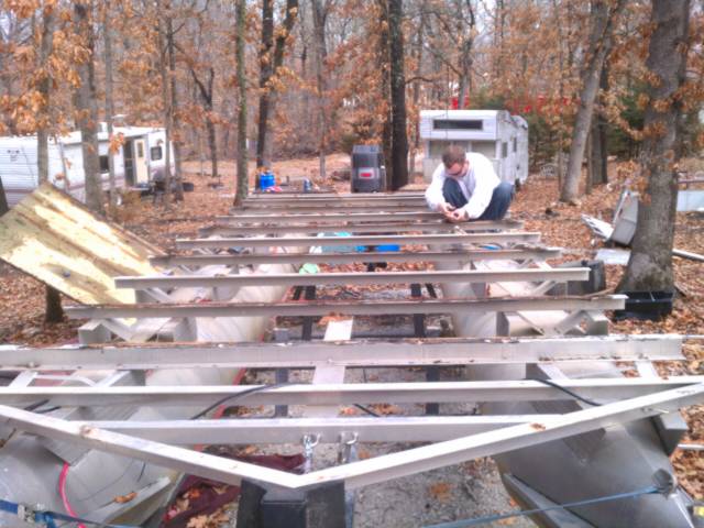

I stripped everything off the deck to run some speaker wire....
Re: DC battery charging and pontoon wiring
#3 Post by curtiscapk » Wed Apr 09, 2014 2:07 pm
Kidding!!! :rofl :rofl :box You can see in this pic you can easily get to the tops of the toons from the side in between the M brackets, unless you have u shaped ones.... then I got nothing for you. :donno
