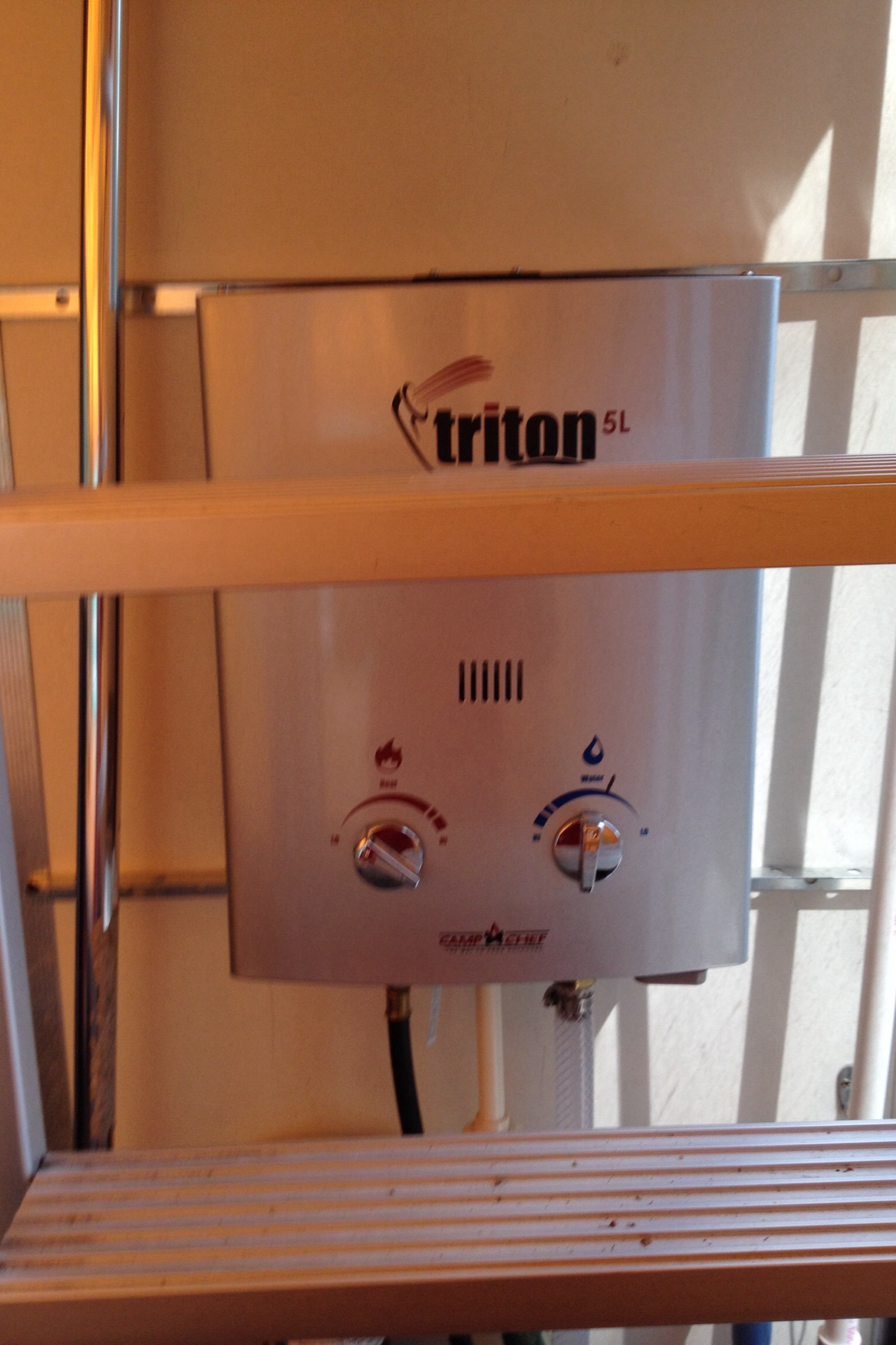

Re: Adding a Hot Water Heater to a Suntracker Party Cruiser
Check out camp chef.com & look at the triton 5L water heater. I'll try to get some pics. & show how I installed
Mounted the heater to the wall behind the ladder.

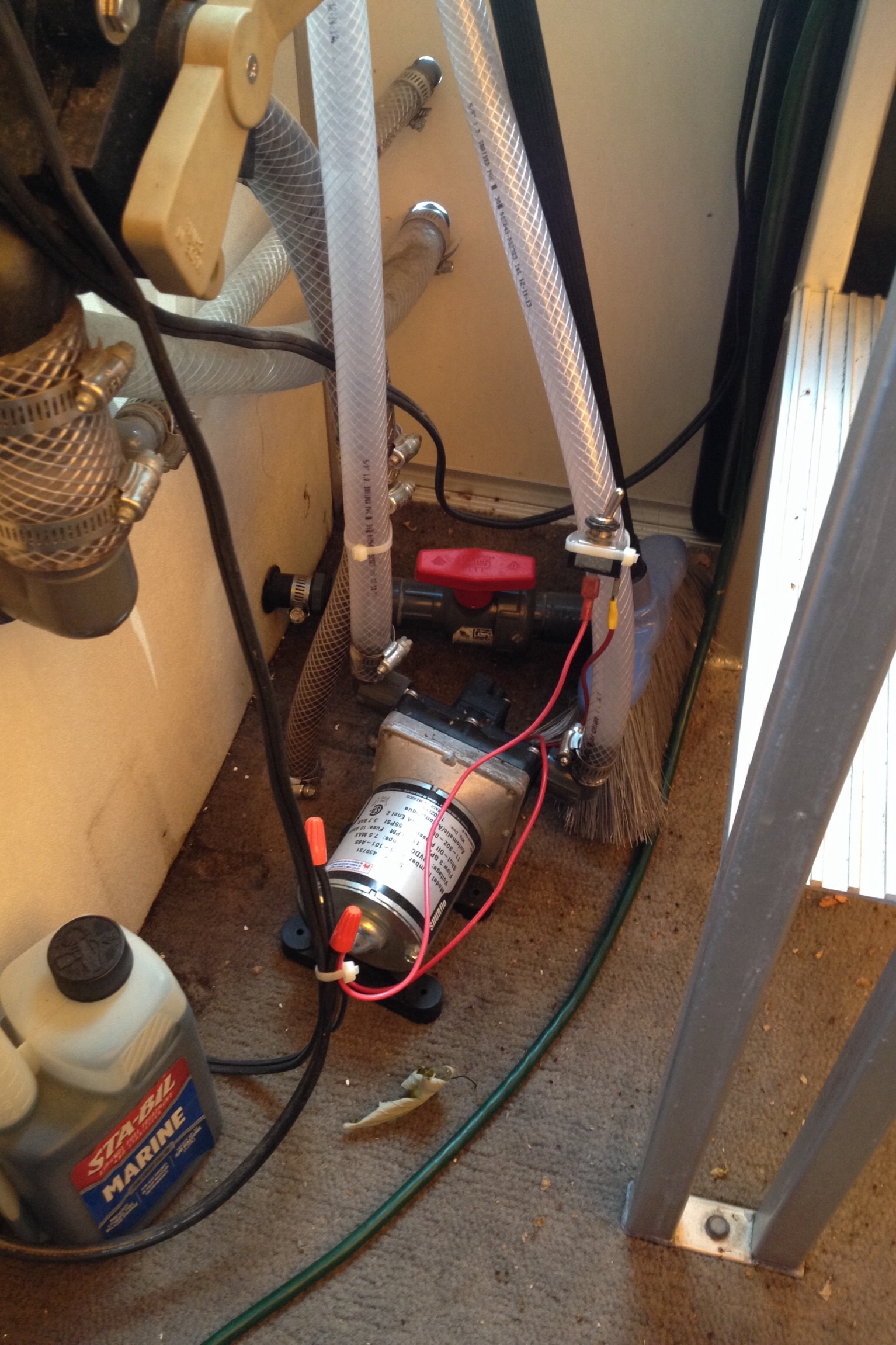

The 12 volt pump on the floor in the same area.

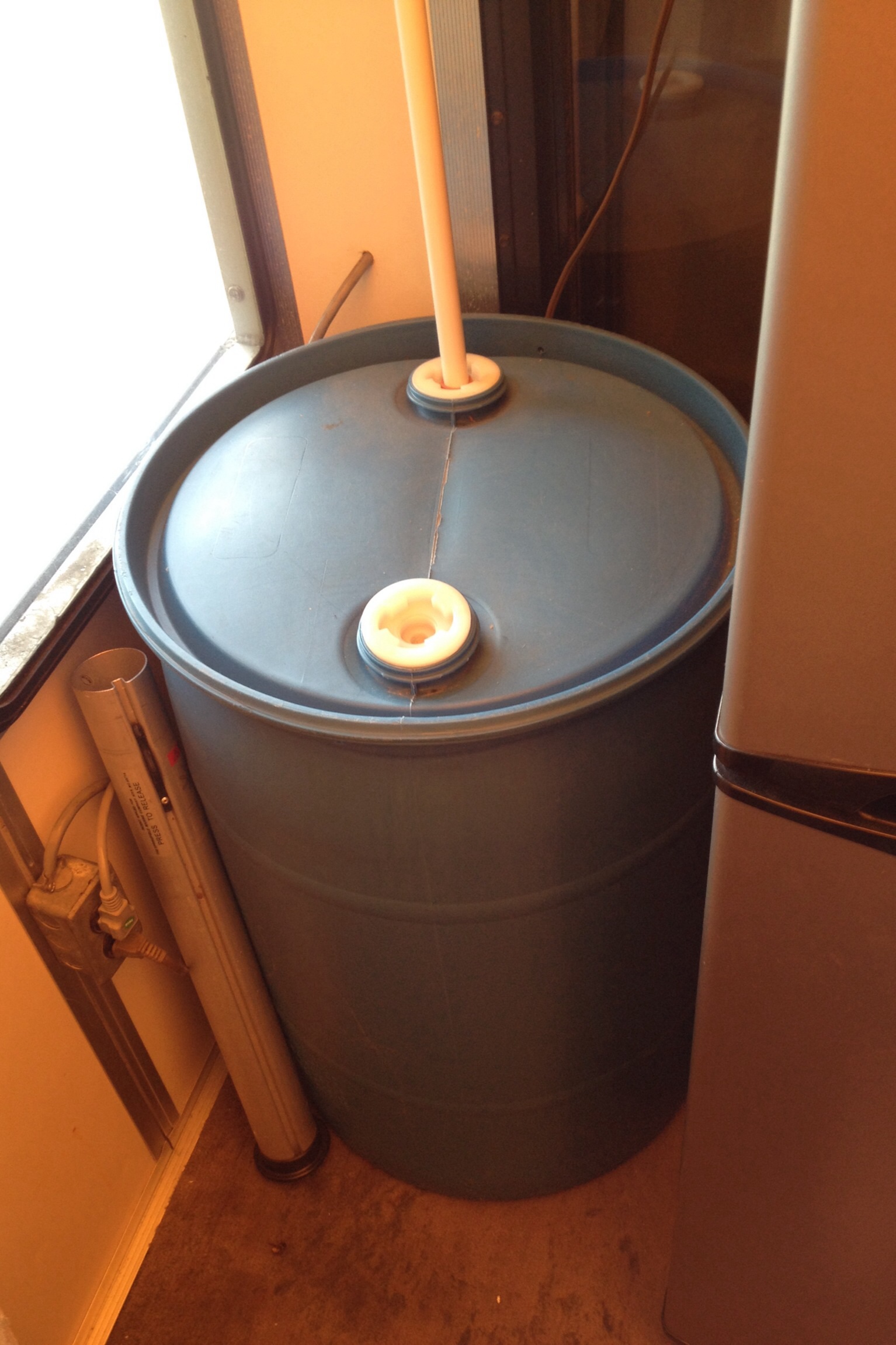

30 gal. food grade barrel & ditched the tank on the roof for more room topside.

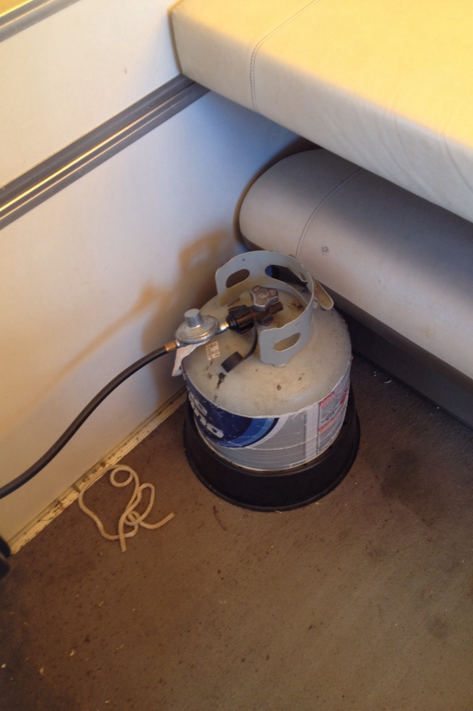

Propane tank is behind u to the right as u face the ladder.
