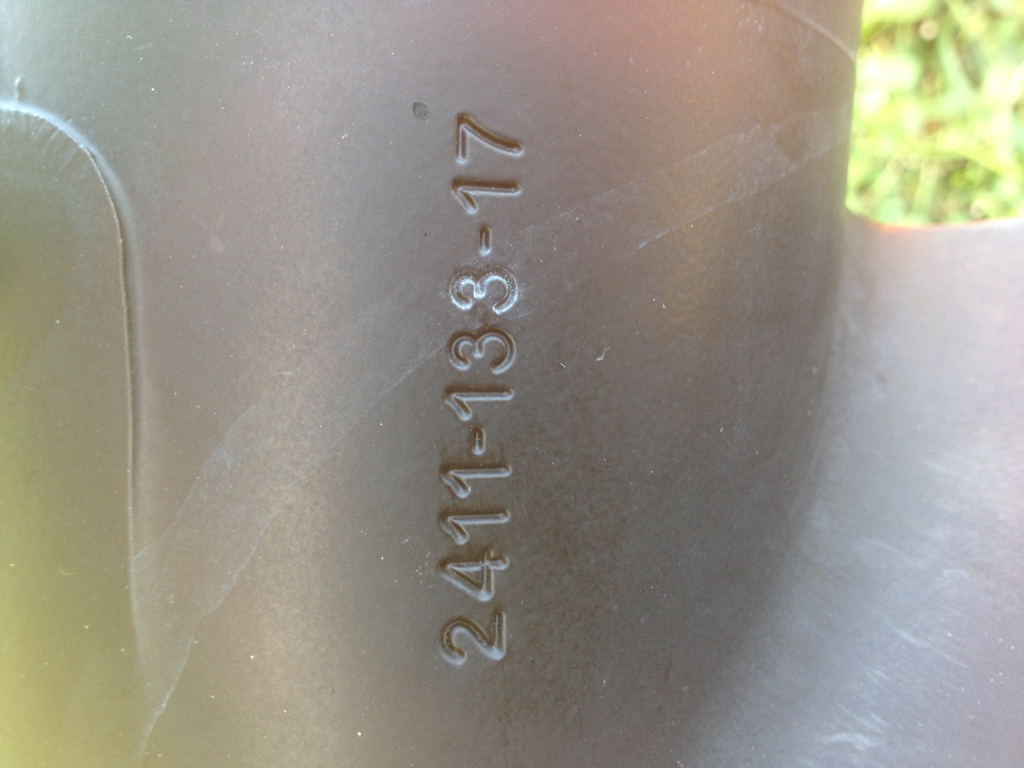

Is this prop to much pitch or do ya think I need to check over the engine ?
Bought a 1993 16ft sun bird open bow with a 90hp Johnson outboard.
Engine revs up good in neutral but when put in gear seems to b a dog & takes a bit to get up on plane & wind out ?
- image.jpg (1.67 MiB) Viewed 2332 times

Sorry bout the size forgot to resize !
03 suntracker party cruiser 3.0 I/O
FAT BOTTOM GIRL
- Posts: 68
- Joined: Sun Feb 05, 2012 10:49 am
- Location: Centeral Pa
Re: Prop pitch or engine proformance ?
Resized
- image.jpg (640.21 KiB) Viewed 2315 times

I used to have pretty well that same boat before I blew up the motor. Mine was a 1991 Sunbird 160 with a 2000 Johnson 90. Pretty sure it had a 15 pitch prop (you have a 17) and mine launched out of the water like a raped ape and did 44 mph on GPS. However, it would over-rev at full throttle so a 17 should have made it slower out of the hole and quicker at top end.
That said, from the way you describe your performance it sounds like you may have some gummed up carbs that need cleaning. (And clean them ASAP before you melt a piston).
What's your top speed?
