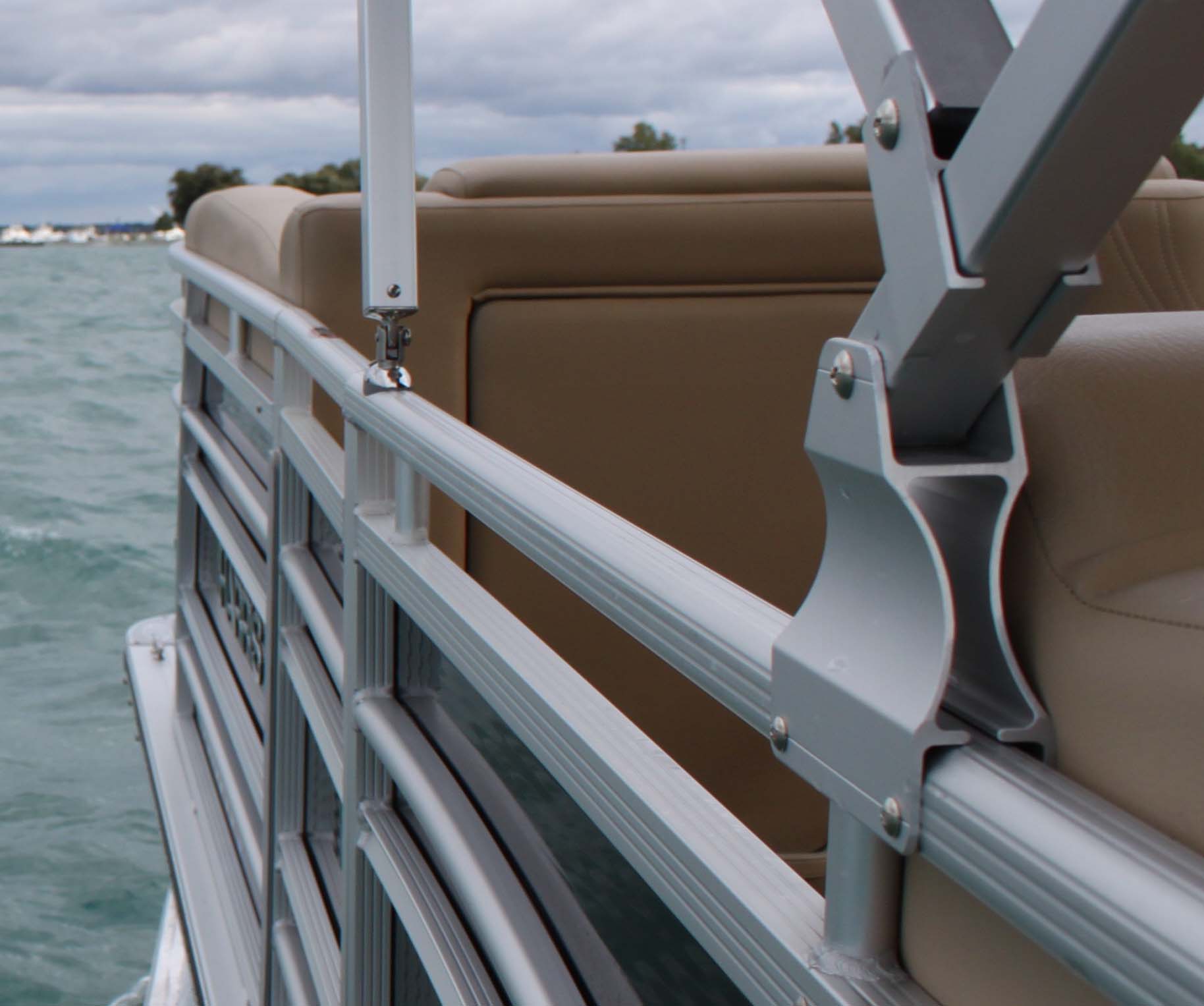

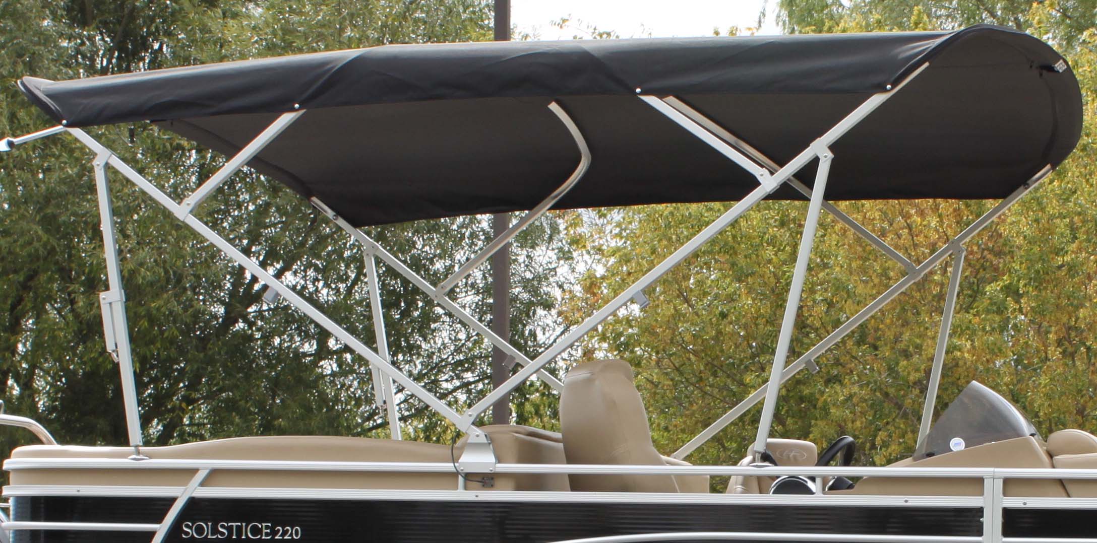

Does anyone know how to collapse a bimini top on a Harris Flotebote Solstice 220?
The dealer orientation left a lot to be desired when we picked it up and I figured there can't be that much to a bimini. I've had several boats in my lifetime and they're not that are to figure out, but for the life of me I can't figure out how to collapse this one. It looks like everything is screwed in and I can't believe Harris would make a top that you had to have a screw driver handy to take down.
Thanks!!!

Unhook the back post from the rail. Fold them into the front post. Put the small arm down and reconnect in the back.
Re: Harris Bimini Operation
Look at the front and rear poles. They connect to the top rail at the chrome fitting. There should be a little square "button" on the chrome fitting. It actually slides in one direction. When you slide the button, it releases the poles, just pull upward on the pole when you slide the button as far as it will go
You just fold it up after that and use the very short poles on the rear poles to store it in the down position.

Yep like they said. Push the button on the rear post fold up then let the small post rest on the rail and connect it to the latch your removed the real rail from

Thanks Guys, your advice was perfect. Everything worked like you said.
