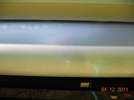

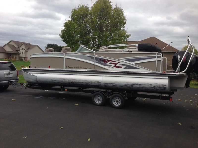

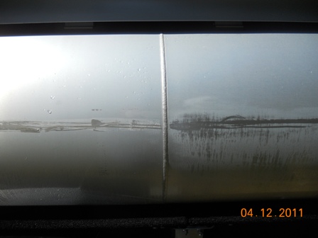

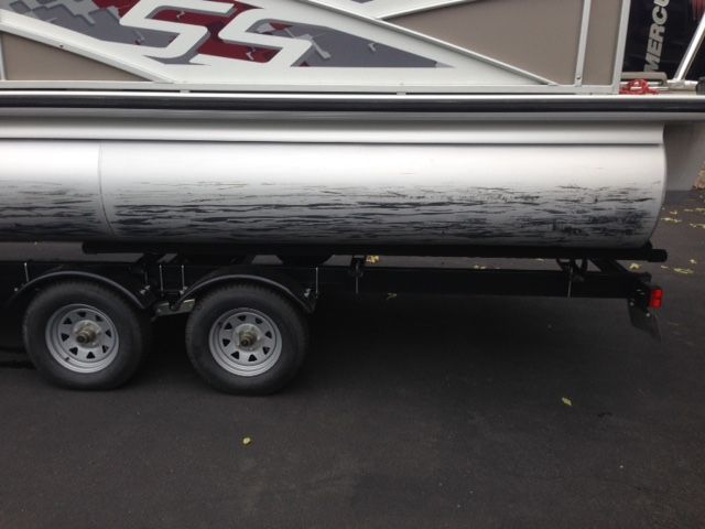

You can go over the scuffed spots with some ToonBrite to whiten them out. Here is the info on the glazing. For a quart, part# SC0001397-$36.00 Gallon Part#1sup96034-$106.00 It would be a lot easier than removing it and polishing. I considered it very hard before I decided to polish. That was only because I polished the previous Manitou's and loved it. In retrospect now. If I was to do it again, I would probably re-glaze. Removing that crap really sucks. Here are some pics. The first is how they looked before I bought the boat. I talked the price down a lot because of this. They looked bad! The second is after washing with the ToonBrite, I actually used the Sharkhide cleaner, but its exactly the same as ToonBrite. Clint just sent me the Sharkhide because I bought Sharkhide polish and protectant to use in my polishing article I wrote for Manitou and PDB mag. You can see how it took out the darkspots. This cleaned the tubes, did not take off the glazing. The glazing came off by letting laquer thinner soaked rags sit on it on pontoons to soften the glazing, then I had to use another soaked rag to scrubb and wipe it off. In some places, a plastic putty knife to scrape it off. When I say it sucks..... It sucks!!! About 3 or 4 hours into it I almost called Premier and ordered the glazing. That's why I say, to do it all over again....Unt uh!!!
If you need anything else, you can IM me if needed.
There you have it!
Bryan

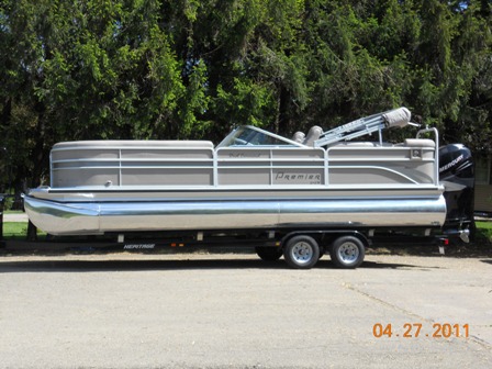

#15 Post by Bryden24shp » Thu Oct 23, 2014 9:46 am
Here's how it looked 4 days later. I was working nights when I did it. But I had probably a good honest 20 to 25 hours in it. And a lot of Aleve in my system afterwards! That's why I ask if it was worth it or not. Maybe....
