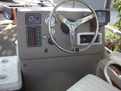

+ 1, normally a light tap and its lose. When i did my rebuild i also looked at the destroyer wheels and found a smoking deal on this one.
new consol 10.JPG (115.56 KiB) Viewed 1649 times
