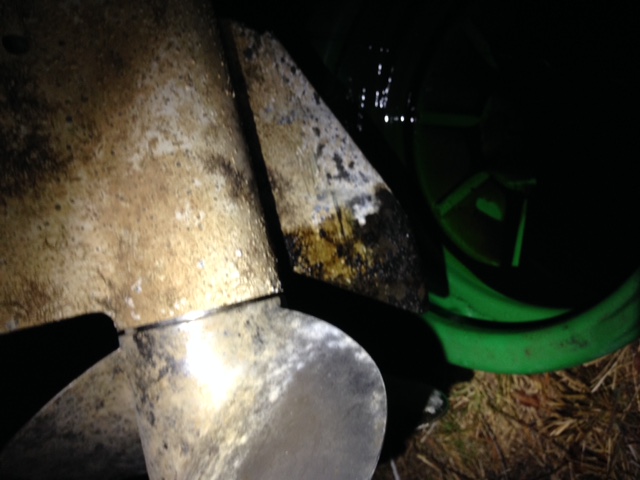

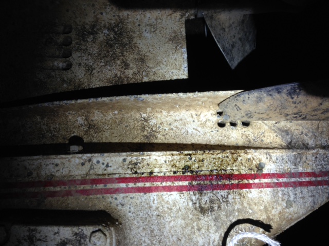

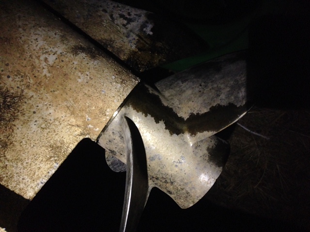

I went outside last night to drain the oil in my gear case of my 1981 115hp Johnson 2 stroke. I have only owned this boat for about 6 months. I noticed oil leaking onto the propeller and a lot of oil on the fin on the bottom. I also noticed oil where the gear case connects to the motor. I drained the oil and found no water in the oil. Do I need to replace the seals on the gear casing? How hard is that to do?

If their is no water in he LU oil then it will be unburnt 2 stroke oil from the exhaust, that's common and it fine.. Now changing the LU seals can be very easy or hard depending on the motor. IF you think it may be a problem run a vacuum / pressure test that removes any doubt or tells you it needs seals. I test mine ever fall when i pull it for the winter, if it fails then i have time to fix it.

I agree with two other answers here. Fuel and oil dripping down. Disconnect your fuel line when not in use and see if it stops.

Older 2 strokes often drip oil, if it's not gear oil it's nothing to worry about. Being that you had clean gear oil supports this. My 115 Evinrude (many boats ago) would drip oil out of the exhaust unless it was winterized and the fuel drained.
