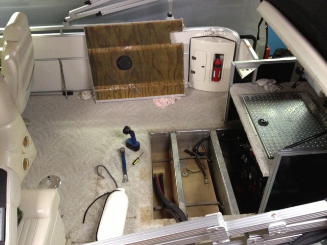

I have some pictures of my boat when I had it taken partially apart if you want them. I have some shots showing where the water was coming in.

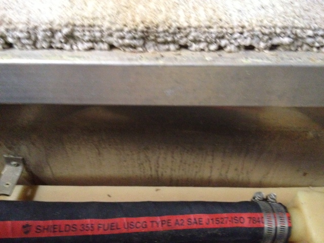

This first shot is a top view of the tank area.
Here's the existing lid installed. It just lifts up with no messing around so easy access. It's important that I can just lift this lid off, as my fuel filter is in there.
I'll also try to find some sort of water absorbtion ball or device so that it cannot pool on the tank. I'll have to pull it out from time to time so it can dry. The round inspection hatch should work well for this.
Summary. Envision wider aluminum strips with thicker weatherstripping. I have one final trick to try. It's hard to describe, but I'll get a picture when it's installed.

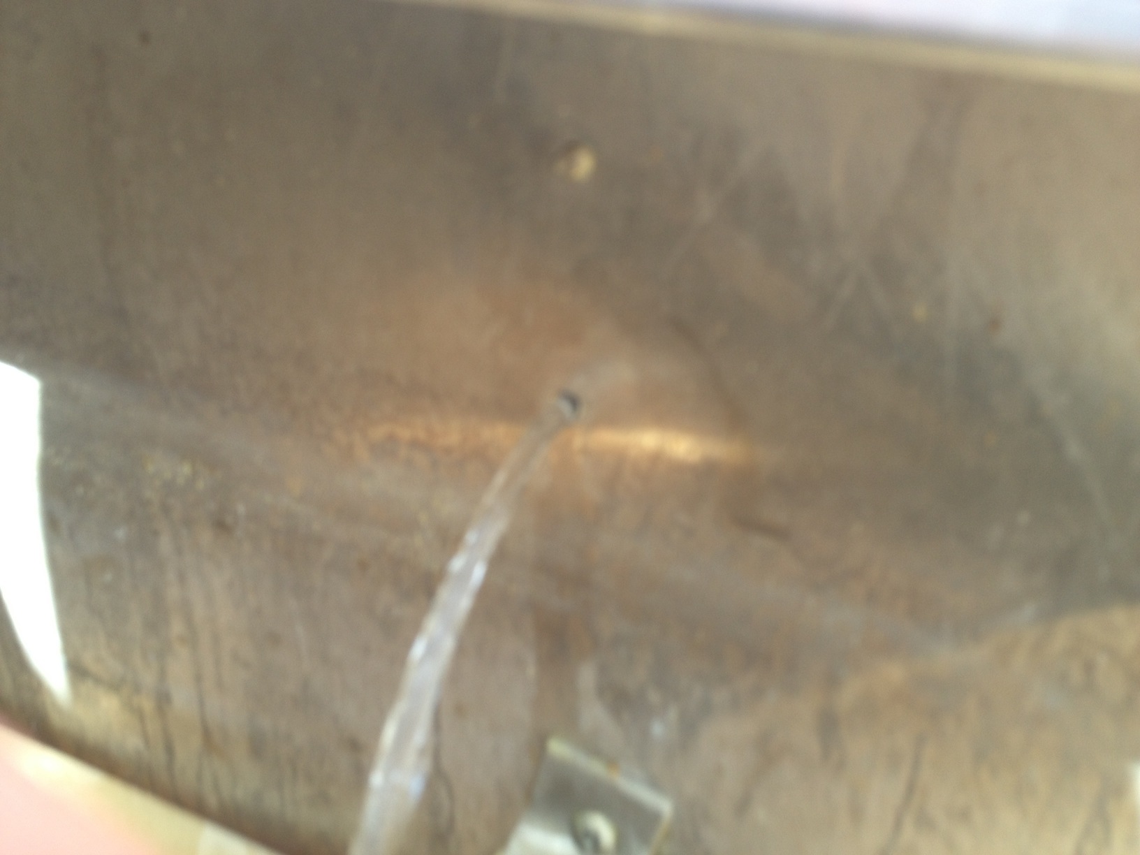

tuned, it sounds like yours is coming in from the top, but you may want to take some steps to make sure of that. Mine seemed that way too. If my boat was out in the weather and there was any source of water from above, then I would have never guessed it was not coming from above. Like yours, the top of my tank would be wet, too, with some water pooling there. If fact that was the only evidence there was a problem, but the source was actually coming in as described in my post above.
It was odd. The tank would be wet -- but how? I live in AZ, it had not rained for months and my boat is stored in a garage. It would only happen after taking the boat to the lake. In my case, it was lake water despite the "evidence" being on the top of the tank.
Here are a few pictures of mine when I was working on it. Check out the stream of water flowing in while under power in choppy water. I have no idea why this hole was drilled in there, but you can see water pouring in. In the stock layout, there is no way to see that area unless you remove the back seat, the changing room area, and then get that floor panel up as described above. I realize your layout is different. Also, on the photo that is called "looking toward bow" (2nd photo below), look closely at the water streaks coming down the inside of the framing. The only way I could get water to seep in and run down there was was also running hard in choppy water. That is the area where South Bay was telling me I could find the water coming in due to the failed seal between the framing and the floor. They were right about that in my case. It was exactly as they described in red in my post above. I am posting that picture so you can see what to look for while you are in there -- just in case yours is letting water in that way, too. There was just enough water getting in that it would be on top of the tank at times.The top of the tank would be wet, yet it was not coming in from the top.
All I am saying is if you have an opportunity to look in there while you are running (you will not need to remove all of the interior as us stock guys have to do) then I would do it. Look closely, while under power, in choppy water, at the area where the floor meets the framing. South Bay was dead on in describing the likely problem and the fix as well in my case.
