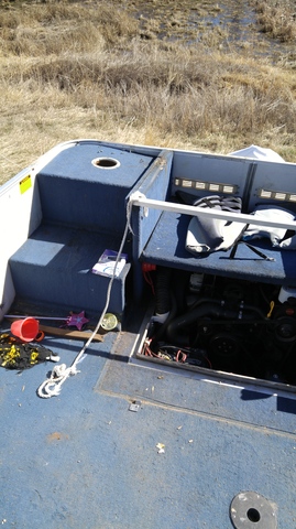

#4 Post by Rockymountainhigh » Tue May 10, 2016 12:14 pm
I'm thinking of sticking it in this dead space frame on the left that houses the gas tank. I'm wondering if it will rattle the hell out of my fencing?

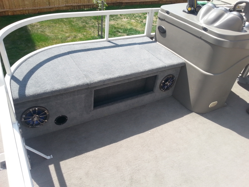

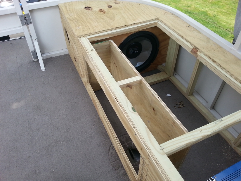

#5 Post by Griggs » Tue May 10, 2016 1:11 pm
I made an enclosure using the outside walls (fence) of the toon. It does in fact make it rattle. It sounds like a loose license plate frame on a Honda Civic with a sub.

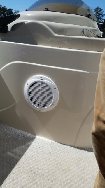

#6 Post by TDJ2591 » Tue May 10, 2016 5:41 pm
I mounted this 10" Kenwood subwoofer in the front of my console. I bought the largest, thickest plastic (?) cutting board I could find (Starboard may have been better but I didn't have a source) then glued it inside the console with 3M 5200 to stiffen the Fiberglass and hopefully dampen the vibrations. I mounted the speaker thru the console and backing and then mounted the amplifier inside the console.
