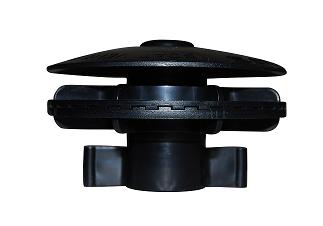

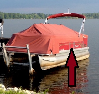

As you can see in the picture, the cover has 6 vents (Boat Vent II), one on the end of each pole. Shouldn't this be enough to keep this boat ventilated?

FWIW, these are the vents that each of the six poles slip into.

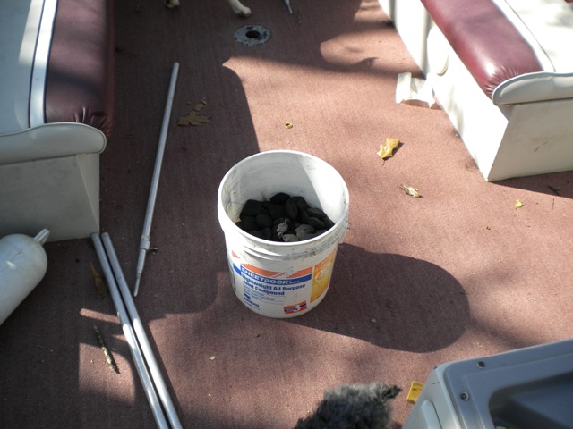

Try a bucket of charcoal... I winterize with one.
- DSCN0568a.JPG (85.61 KiB) Viewed 6102 times

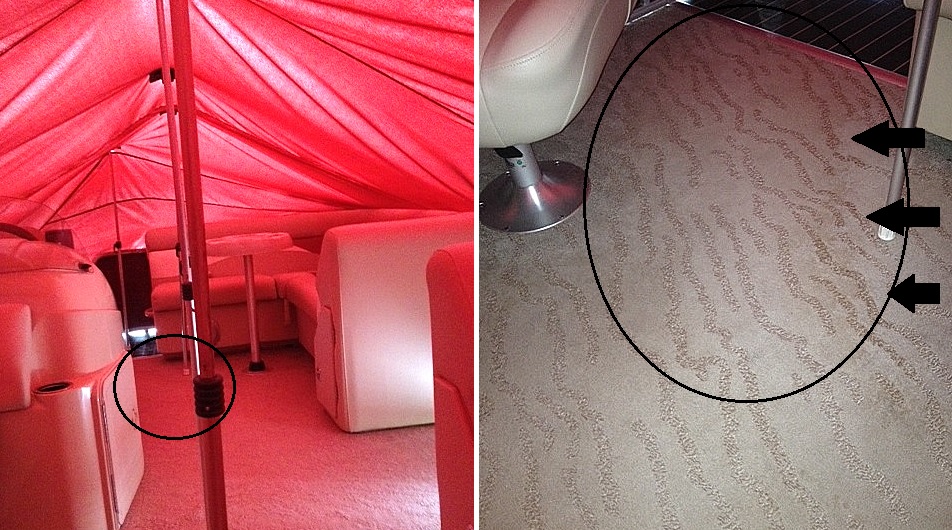

Re: I GIVE UP! Condensation under mooring cover...
Here is the area that I'm talking about. I took a pic under the mooring cover this afternoon. There wasn't a puddle today, but you can see a mild discoloration of the carpet where the water was.
Vinyl floor in back is never wet, just the carpet in the area noted.
KPC
