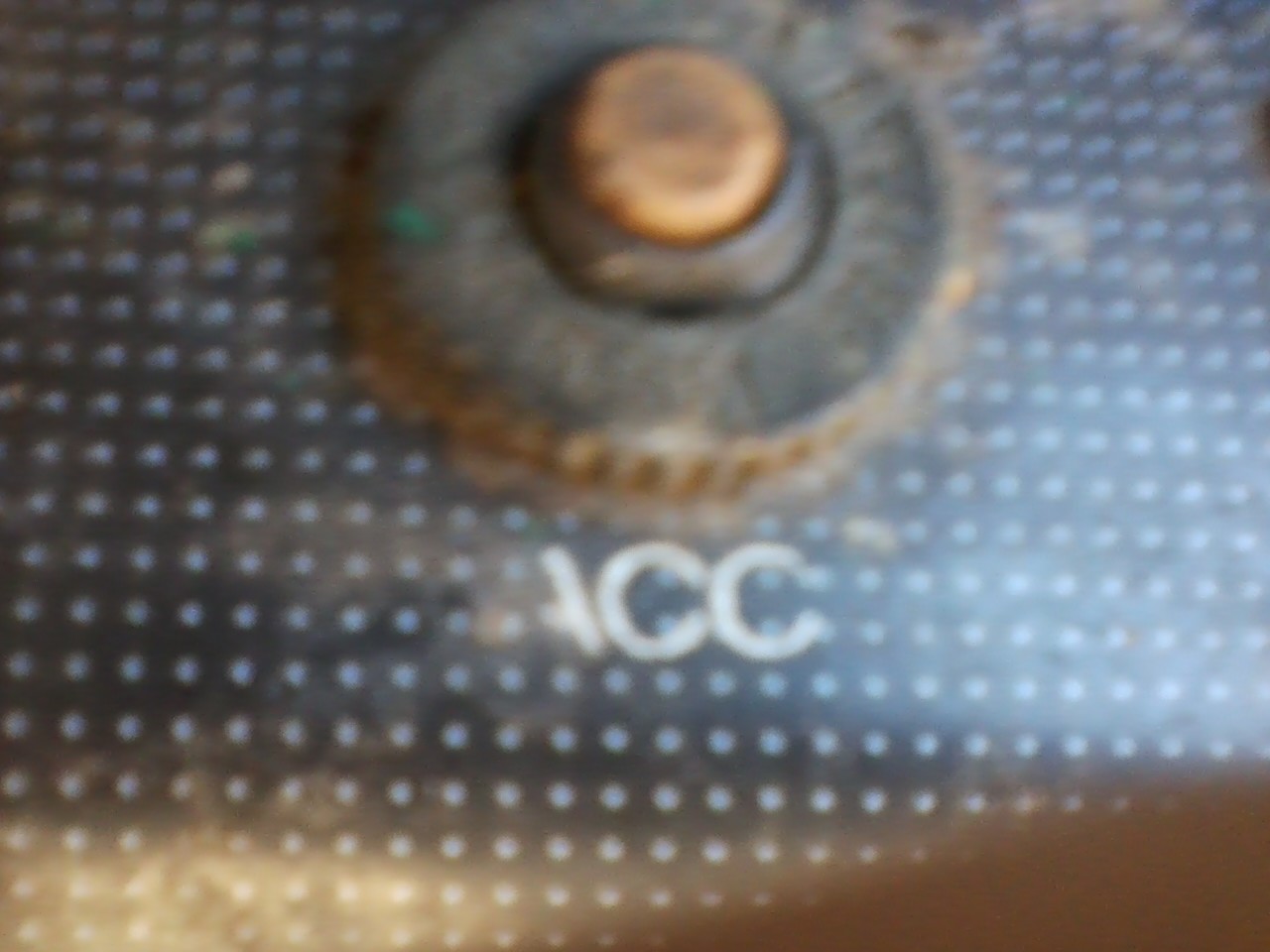

does anyone no where i can find the layout of the console buttons on a 1991 this is what the buttons look like but i can't read wha they say

more than likely you will have to make them your self new switches and some pvc stick on names or a lot of trophy shops can make a plates with names in plastic or brass

I believe acc stands for accessory as in extra to add something to. might have to follow wire from back of switch or check if it is even used. on mine one was used for the livewell pump and another was for the fishfinder.

I think what you are not able to read/see is the amp rating of that circuit for that fuse/switch. Not sure where you might find the panel layout but replacements are to be found at....
https://www.jamestowndistributors.com/u ... ush+Button
What you would need to determine is what device those fuse/switch combos control so you can size the amp rating correctly. I'll bet most are not labelled with amp rating. Mine are not. I suspect most are 15.

That looks like a circuit breaker to me and not a switch. I have them on my boat below each switch instead of a fuse block.

agree. circuit breaker for accessory
