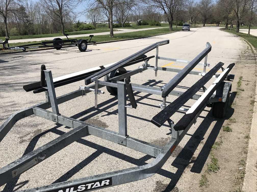

In an attempt to cover all the bases, (or maybe just to be half-assed) I've used Caliber wrap on one side of the bunks and PVC slides on the other. Got the Caliber on sale at Walmart.com and the boards from Ebay. This coupled with the nifty 4-C Innovations guide system has made my trailering ramp dance a thing of beauty.
