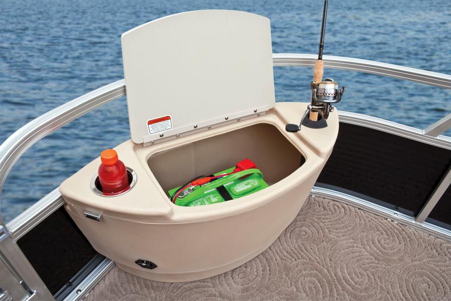

3. Are all the little... consoles or cup holders at the front of these boats, basically the same shape? I'm going to order some new ones and I wanted to make sure that the ones that I order, end up fitting properly. They sit flush up against the inside of the fence, in the corners and will often have cup holders or some storage.

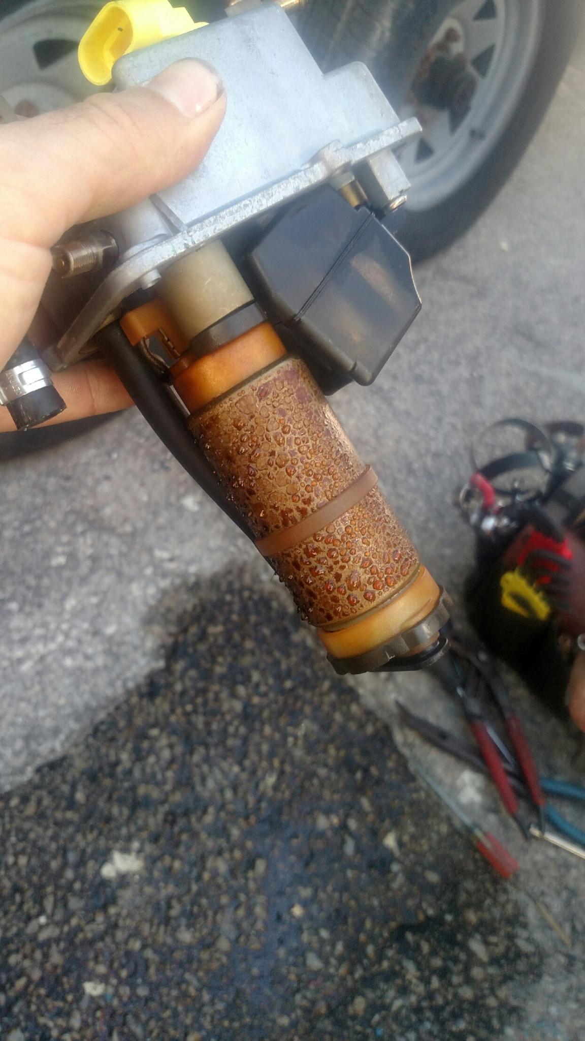

Are these items that I point to in the pic below, what I need to replace? Well the one on the engine hopefully doesn't need replaced. Need to pull it off and clean out the screen I guess. But can I just pull that thing off of there? It looks fairly easy to get off. But will I need a gasket set in order to reinstall it? Also I'm looking for that water separator filter but I'm not seeing it. Maybe its in that thing by the battery?
- FLOUNDERPOUNDER225
- Posts: 314
Re: A few questions for this boating season (Engine trouble, vinyl repair)
for clarification, this is a 2015 90 hp 4 stroke correct? not a 2 stroke? the arrow is pointing to the low pressure FUEL PUMP operated by engine vacuum/pressure, those are very simple to remove and open up to look and see if there is any contamination inside, most of the time the gasket can be re-used if your careful removing the pump from the block

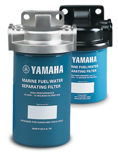

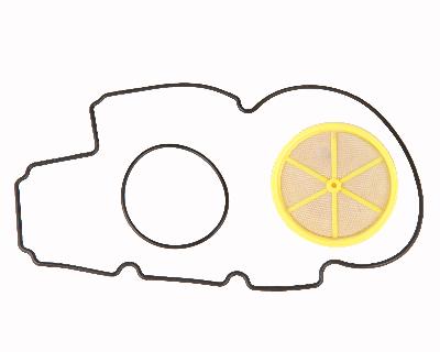

I don't know of any "metal screen" in your fuel system, ATTACHING some pics here, the water separator is the spin on filter, not all dealers install them, I would highly recommend installing one, doesn't have to be "Yamaha" sierra brand makes one, doesn't matter but it should be 10 micron filtration. next is the VST filter, it is a screen but no metal, its a round plastic device that attaches to the bottom of the electric fuel pump, you remove the top of the VST and the pump motor is attached to it, clean the bowl out, twist and remove the filter from the bottom of the pump motor and install the new filter, these filters ARE NOT cleanable, you may think its clean but it's not, especially after what is most likely very bad fuel in there. there is a small oring that goes around the top of the VST tank, sometimes a bitch to keep in the small groove while putting the VST back together, a very small amount of grease is a few locations around the perimeter of the groove will keep the oring in place while putting the top back on, it MUST NOT roll out of the groove or you will have fuel spilling out while running around in the boat. its a little tricky but patience works, also take the oring out of the package a day or so ahead, and place something on it to get it spread out, it comes all folded up in the packaging. and make sure you replace the clear bowl filter on the engine, all of this is available from SIM Yamaha, or your local dealer. when starting the engine after all this, first you will have to prime everything with the squeeze ball, your filling the VST tank, and on your spin on, if you get one, YOU MUST fill it with gas prior to spinning it on, this is just like priming a diesel fuel injection system.

So I guess now I'll just talk more about the storage consoles by the corner of the fence. Like in the topmost pic. What are the odds that if I ordered some, they'd follow the same contour as my particular boat? Maybe it would just be "close enough"? And is anyone aware of a good seller of those things? Seems pontoonstuff is currently not selling them.
