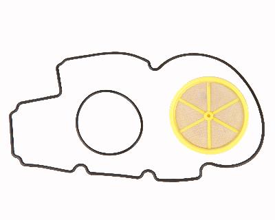

Your engine has a VST (Vapor Separator Tank) which has an electric fuel pump and screen filter, if your engine sat with ethanol fuel for 1.5 years (as mentioned earlier) your in for some fuel system maintenance. The 4 strokes have a series of filters, first your water separator (if you have one) then the clear bowl filter on the engine, then the filter in the VST then a high pressure filter and finally there are small basket filters on each injector. Ethanol fuel that has separated is called phase separation, with water present it forms little crystals that are brownish in color, they will completely clog your fuel system and corrode components. unless your reasonably mechanically inclined you will probably wind up at the repair shop. even removing the old fuel from the tank does not remove the bad gas in the rest of the system. Not trying to ruin your day, but I have seen this many times, and owned a few Yamahas that were left like this by previous owners. Its not cheap, but an education seldom is.

I don't know of any "metal screen" in your fuel system, ATTACHING some pics here, the water separator is the spin on filter, not all dealers install them, I would highly recommend installing one, doesn't have to be "Yamaha" sierra brand makes one, doesn't matter but it should be 10 micron filtration. next is the VST filter, it is a screen but no metal, its a round plastic device that attaches to the bottom of the electric fuel pump, you remove the top of the VST and the pump motor is attached to it, clean the bowl out, twist and remove the filter from the bottom of the pump motor and install the new filter, these filters ARE NOT cleanable, you may think its clean but it's not, especially after what is most likely very bad fuel in there. there is a small oring that goes around the top of the VST tank, sometimes a bitch to keep in the small groove while putting the VST back together, a very small amount of grease is a few locations around the perimeter of the groove will keep the oring in place while putting the top back on, it MUST NOT roll out of the groove or you will have fuel spilling out while running around in the boat. its a little tricky but patience works, also take the oring out of the package a day or so ahead, and place something on it to get it spread out, it comes all folded up in the packaging. and make sure you replace the clear bowl filter on the engine, all of this is available from SIM Yamaha, or your local dealer. when starting the engine after all this, first you will have to prime everything with the squeeze ball, your filling the VST tank, and on your spin on, if you get one, YOU MUST fill it with gas prior to spinning it on, this is just like priming a diesel fuel injection system.
VST FILTER.jpg (13.42 KiB) Viewed 8938 times
VST FILTER KIT WITH GASKET.jpg (11.02 KiB) Viewed 8938 times
