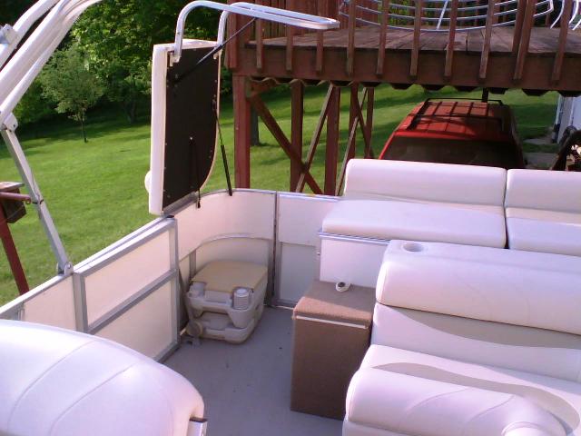

Ours came from the factory with a 29 gal. fuel tank smack dead in the middle right in front of the motor. It should be an easy and practical move I'd think and fairly easy to pull off.
fuel tank odyssey.jpg (52.61 KiB) Viewed 7459 times
The fuel tank is behind the curtain.
porta john enc..jpg (52.65 KiB) Viewed 7459 times
It still allows a walk through to back of boat.

#6 Post by Bamby » Sat Mar 27, 2010 5:39 pm
The boat I pictured has the storage under the right outside just above the toon. We keep some life-jackets and bumpers (light stuff) in that storage area. You see the pull op cushion in the middle of your back seating area, anyway that's where the batteries are installed also dead in the middle of boat in front of fuel tank. Makes for a well balanced boat as far as the necessary heavy on-board fundamentals go.
