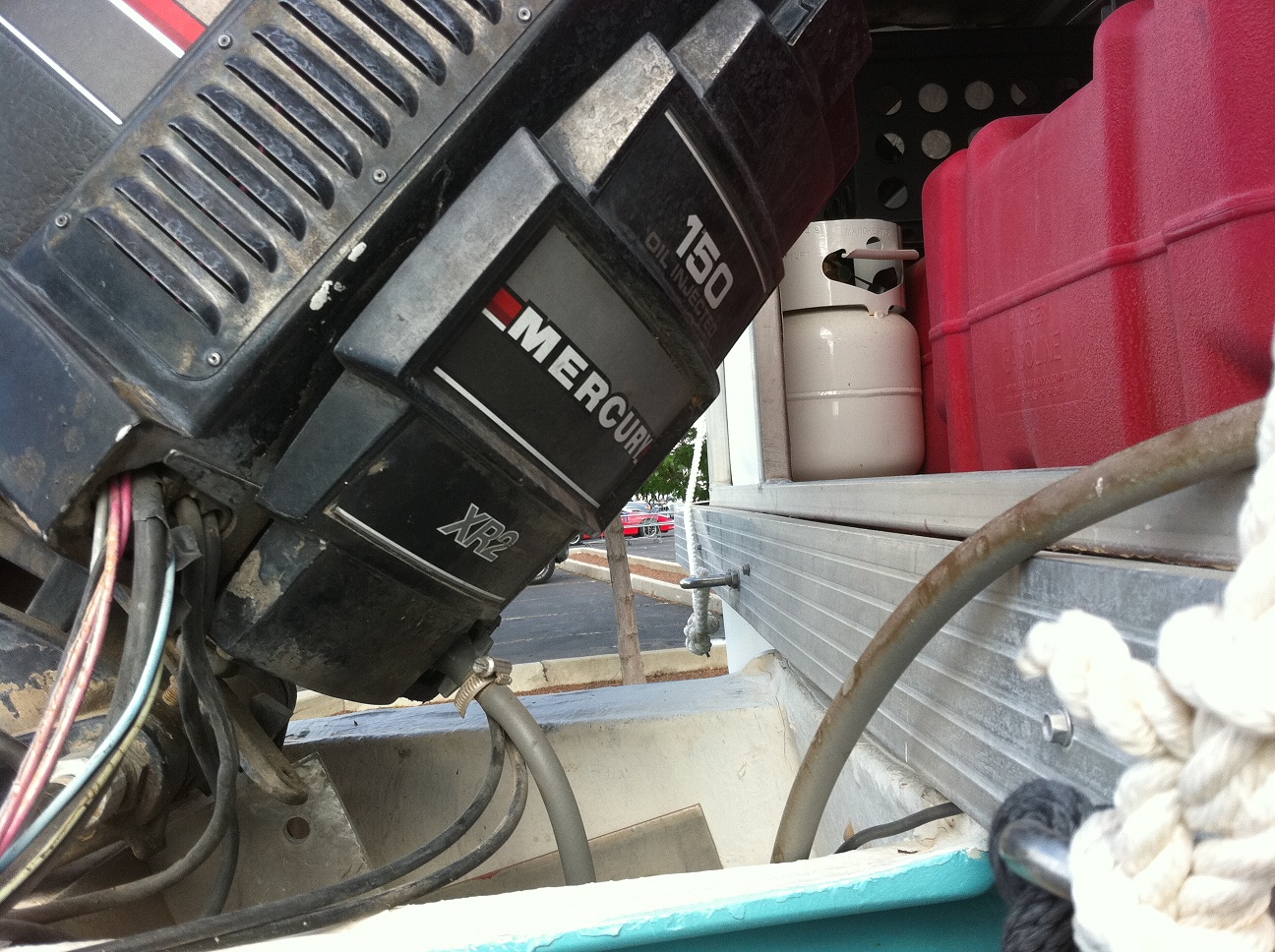

well i took the drive to go pick up the boat in vegas...8 hour drive there...16 hours back towing that beast!!!!! damn it was a long drive. sigh...here are the specs on the boat as per the title
1985 aqua cruiser Playmate
has a 150 mercury blackmax XR2 engine on the back... I have ordered an impeller and new plugs for it...what else do you think i need to check before attempting to start it?

think i would check compression new set of pugs and of course a bat. maybe new fuel line with water seperator. at least a fuel line for now flush any old gas use a portable tank for first try unless the old one is in awsome condition. and a beer.

I think you got it put on the muffs and turn the key!

I would make sure the thing is fairly clean before I tried starting it as well. If you have a leak, you may not know where it's coming from with the engine dirty and such. Good luck to you, and hopefully she fires right up after some maintenance. :thumbsup

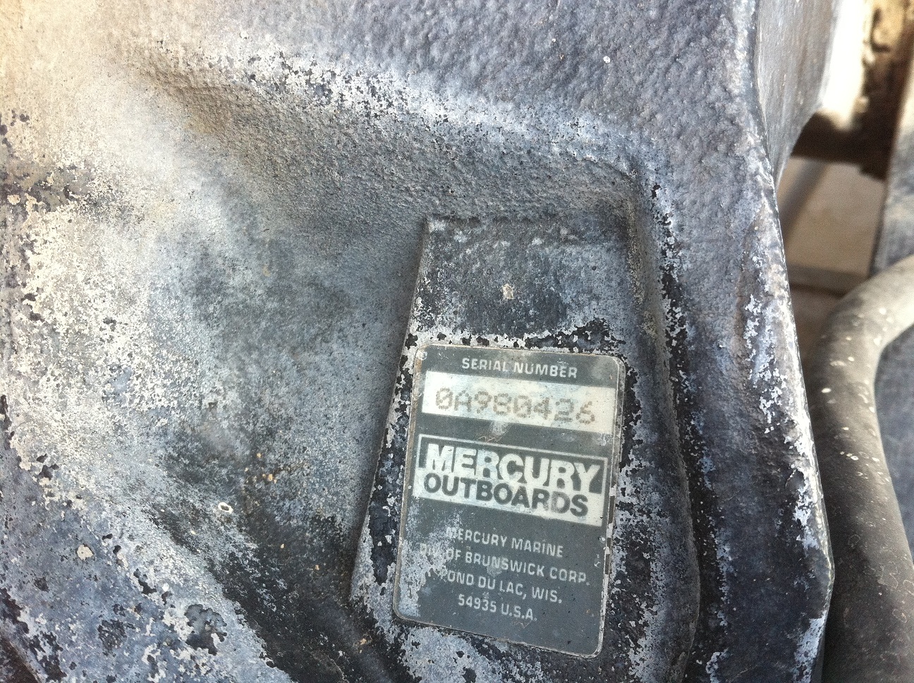

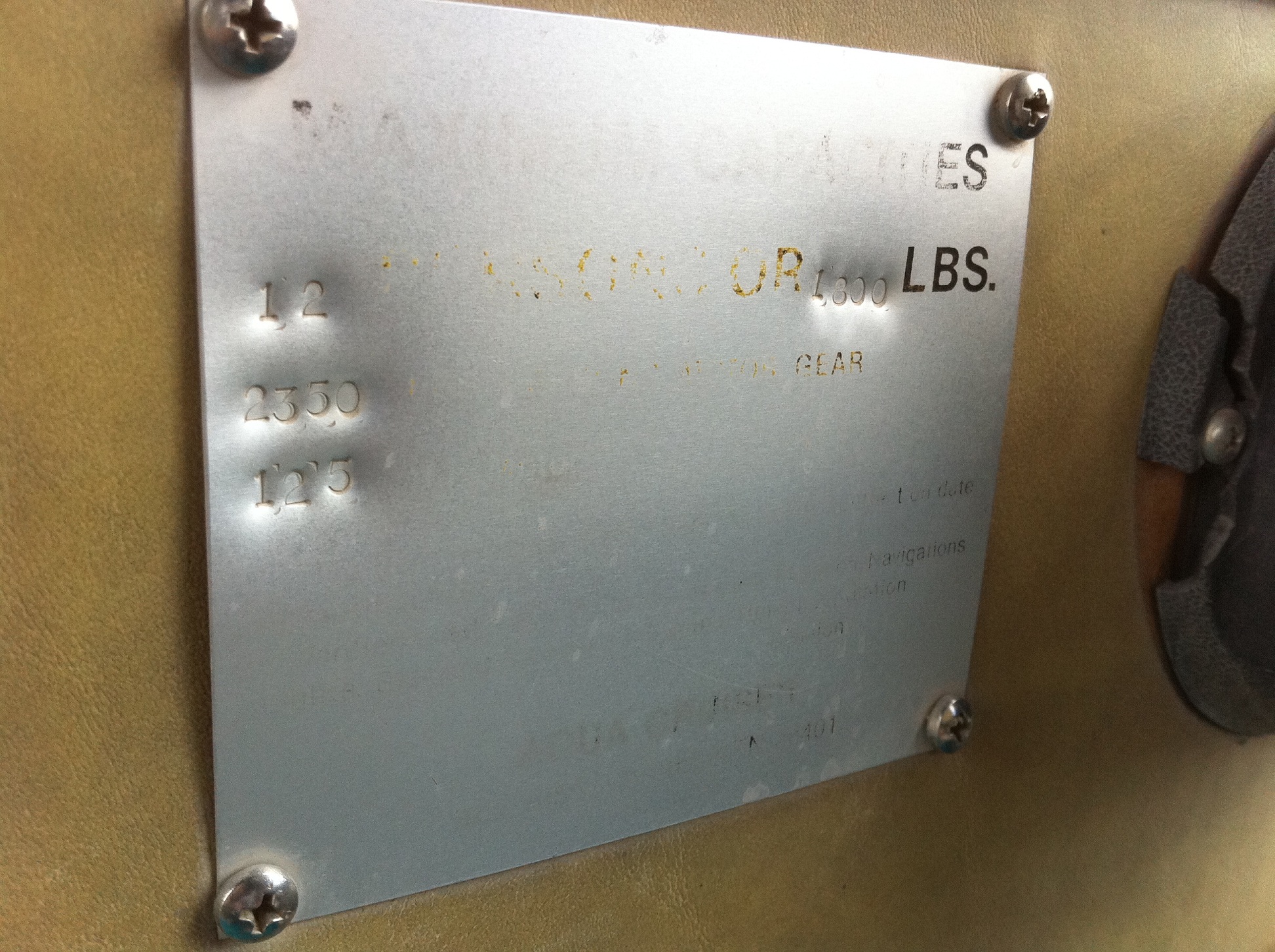

how do i figure out what year the motor is....i think the engine has been changed. The reason i say that is the cert plate on the boat says max 125 and there is a 150 on it so it could be a dif year...

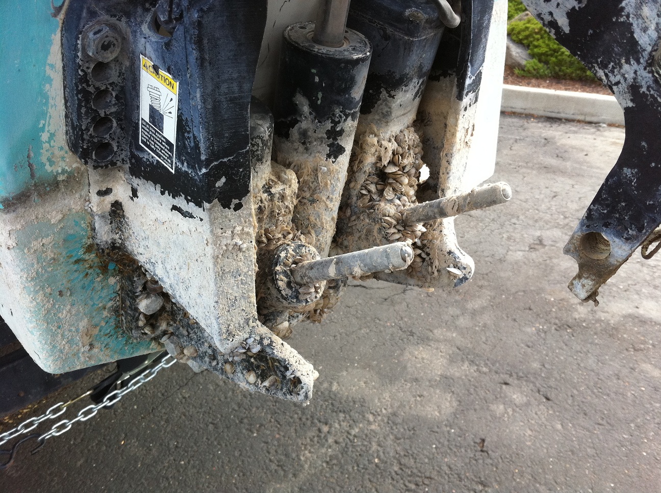

Holy Barnacles batman, that bad boy has been sitting for a while I guess? Get out the putty knife and pressure washer!! :nana

i just hit it with a whimpy power washer and you should see the crud on the ground now. :) I still have a lot more to go but getting there.

well today i replaced the impeller and the plugs...got some clean glass and did the mix. the carbs were not gummed up which was great...after a few hits on the starter it roared to life...It was not peeing so got to working on that. I pulled the thermostats to help the flow for now. Going to be installing some new thermostats so not to worry...wont be on the water until they are in. well after pulling them still was not peeing. pulled the the actual pee'er and and it was packed with crustacean about an 1/4 back. cleared it out and we have peeing!!! so it does engage in drive and goes into reverse and pees. once i get the thermostats in then it is testing time on the water.

I am worried the cooling system is clogged with Zebra Mussles

Make sure you bleach any live wells and anything where a zebra mussel has been or could be. They are nasty critter that ido not hink you would want to be responsible for planting in a clean lake.
