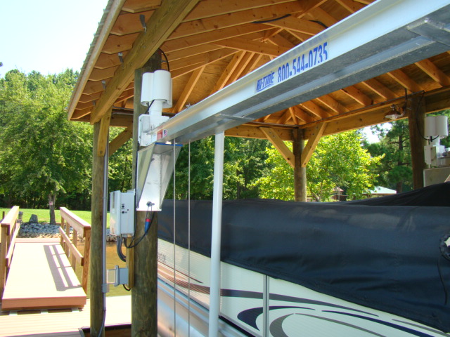

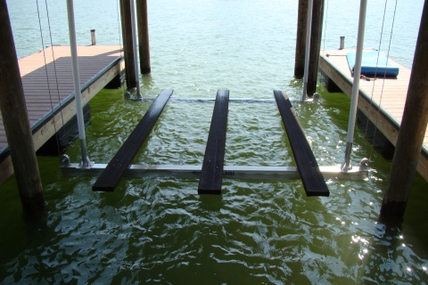

Here's some pics of ours Pammy. We don't have bunks like a trailer has but 2x12's that are covered. The poles on the side keep the boat lined up and it's pretty easy even when windy or choppy.

Carl: That is some kind of first class heavy duty lift. Looks like it'd lift a 30' Sundowner with the double pull pulleys.
Most lifts on our fresh water lake are Ace style 4000 lb. lifts like the kind sold @ Overtons. Double 2x8 runners are placed flat on a 4" channel steel frame that's welded offsite into a 10' by 15' rectangle with 4 crosspieces. They're brought in for installation on small barges with cranes.

It's a 9000 lb Hi-Tide with remote for the lift and lights. A little overkill but it was only a $600.00 difference between 6000 lb and 9000lb.Bamaman wrote:Carl: That is some kind of first class heavy duty lift. Looks like it'd lift a 30' Sundowner with the double pull pulleys.
