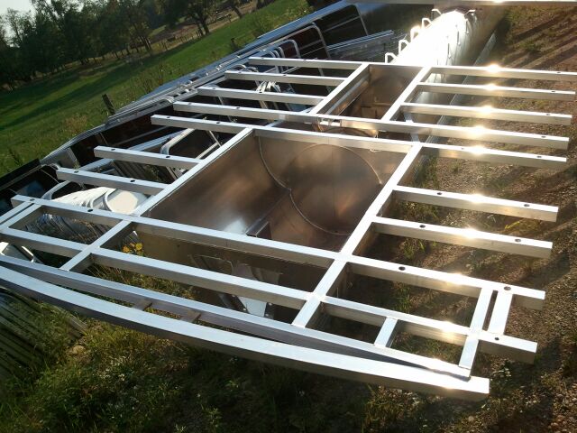

Well since nobody is telling me that its the craziest idea since the shake weight... how about ideas on what I could use for a suitable transom? Do you think a standard V8 transom (3rd tube) would be long enough? Or is that too generic and I need to do some measuring? Find a suitable boat donor and measure the inside dimensions and then compare them to 'standard' I/O transom (3rd tubes)
thanks for entertaining the crazy guy..
-ron
ToonGuy
Posts: 968
Re: Has anybody ever seen an inboard (I/O) straight 6 pontoon?
#11 Post by ToonGuy » Fri Aug 10, 2012 8:34 am
Here ya go...OR I have a complete tri-toon chassis that used to be a 5.7L I/O :smoke

ToonGuy, your pictures are a bad influence on all of us. If you ever run across a center toon that will fit a 2007 South Bay 922CR with outboard let me know... My wife likes the sounds of a v8 inboard..but I pay the pontoon fuel bill..
But for a project like this, your pictured center tube structure would put it right out of any cheap budget...
