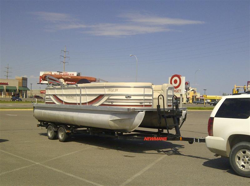

Not mine
Mine

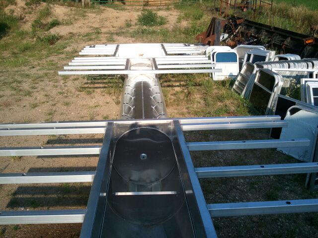

The full tube is like the one toonguy posted on another thread, where the cross braces for the front and rear are pre-welded at the factory and would require me to redo the decking.
Picture of ToonGuy's project tube
Which is why I also included the pricing for plywood and side molding. I also got prices for new replacements of the outer tubes because if I went this way, I might want to 'upgrade' to a 25ft deck to get more front porch area or a rear swim deck area, which would also require some rewiring and most likely new control and steering cables.
