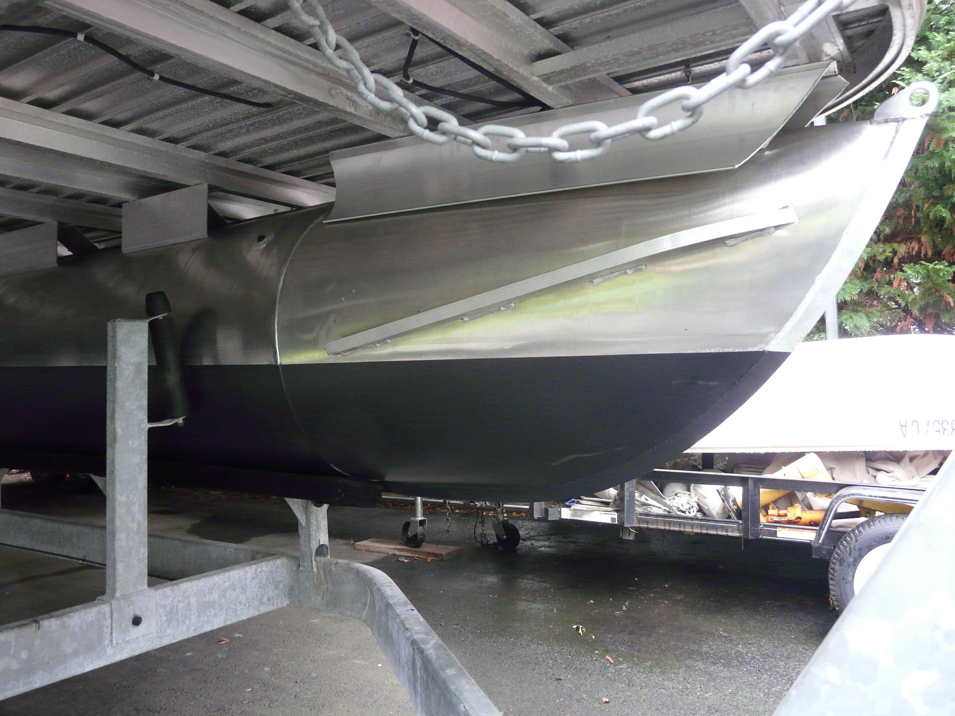

Most Tracker boats prior to 2007 have all aluminum "Duradeck". No plywood anywhere.Nusse wrote: First, the deck made in wood, subjected to water spray from beneath......
Second - I can see how it would greatly reduce drag and make for smoother flow.
Any manufacturer that deliveres their boats with a metal bottom or "skin" as a option or standard?
- P1170934.JPG (3.62 MiB) Viewed 2833 times
