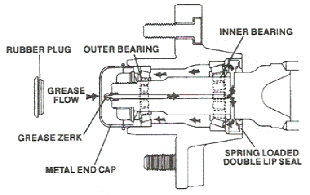

Personally I replace ever 4 to 5 years or is I see any cracking at all, have changed one by the side of the interstate once and I sure do not want to ever do that again. When I bought my new trailer I made sure it has the safety lube hubs I rejected a bunch of trailers because those didn't have those. For that those who don't know what that is its a system that allows you to completely flush and repack a hub in 5 minutes with out having to take it apart.
- ez_lube.gif (37.43 KiB) Viewed 3014 times

YEP I like em too, a fast grease change and your goneMH Hawker wrote:Their is a manufactures date code branded into the side wall of all tires and most last 5 to 6 years depending on use and how strong the sun is in your area. Watch out for buying brand new 3 year old tires it happens a lot.
