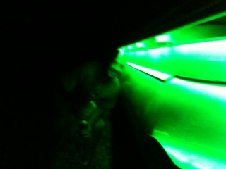

#9 Post by schmir » Wed Apr 17, 2013 1:23 pm
Here is a picture of mine. I bought 2 16 foot kits and mounted one on each side of my toon. They have about 6 different color options. They can also rotate or flash. I can also set one side to solid green and the other to solid red. I assume this would be legal at night. Have not asked any law enforcement yet though.

#10 Post by redbeard » Wed Apr 17, 2013 2:45 pm
I would say that its not can't tell if you're coming or going.

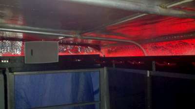

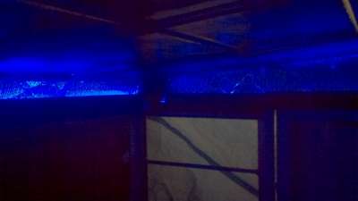

#12 Post by tuned » Thu Apr 18, 2013 1:51 am
Hey warrenm81.
I run 5050 lights as well. They are inside my sleeper shack, so I don't have as many potential legal issues. I love the color options, although the flashing stuff gets old pretty quick. They will get the girlies in a dancing mood from time to time :nana
I mostly use them for house lighting when docking-bright white for people to locate gear, sandels, purses, bras, and small dogs. I sometimes use a very dim red when night running, just enough to be able to find things but not enough to destroy night vision or confuse other boats.
Blue or purple for party places-usually with a SMALL amount of movement, but not enough to be annoying.
This is the second set that I've owned. The strings I got were really cheap and flimsy, the controller doesn't have enough choices, but they still look great!
I really miss my old ColorStorm that I had on my long lost cuddy. Way better control and choices, with LEDs in bulletproof tubes. They don't make them any more.
I am looking into better control systems, possibly DMX (smart digital used in the bands). I speak DMX fluently, but 12 volt DMX is a bit rare and expensive. Control is everything.
A word of advice for mounting. It is very important to mount them where you cannot directly see the LEDs if possible. They are very bright and will harsh your mellow. Indirect lighting is the only way to go. Here are a couple crappy phone shots of mine. I will be getting better shots after I launch and posting them in my build thread.
As you can see, I had to build baffles to get the indirect lighting effect. I had to do the same with my old system. A final word on where to shine them, try to find a light colored (white, light gray etc...) surface to aim them at so they will show nicely. The new boat aims at shiny silver here which works well.
