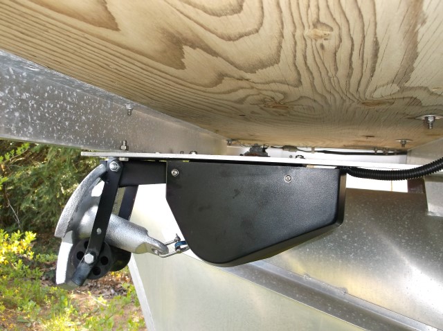

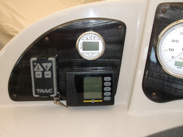

Getting ready to launch soon so I finally mounted my power anchor. My kids gave it to me for xmas and I just got around to installing it today. I didn't want to mount it topsides because of tripping over it and drilling holes in the deck. I got a 1ft.x 2ft. 1/4" thick aluminum plate to span the floor joists and bolted it up. I had to modify the davit to make it work upside down, ran the power wire down the port tube to the battery, and the easy part...stuck the wireless remote on the dash.
It's a Trac 35 for pontoons, I read the bad reviews about the plastic drive gear failing in the older models, so the company upgraded to steel gears. I opened up the gear box just to be sure, and it had the metal gears. I was concerned about the strength of the 1/4" braided anchor line, (I always used half inch line on a fluke w/ 5ft. of chain) but I anchor mostly in sand or mud, and shallow, so I'll try a river anchor. We shall see, I'll let ya know how it works out.
DSCF1502 (Custom).JPG (154.41 KiB) Viewed 13342 times
side view.JPG (176.96 KiB) Viewed 12937 times
dash mount.JPG (133.74 KiB) Viewed 12923 times

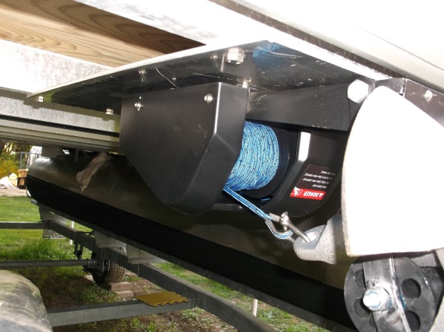

It looks good. I can't tell from the pics but will water be able to get into the housing easier like that and affect the motor or is it sealed and self - draining?

jrolin1 wrote:It looks good. I can't tell from the pics but will water be able to get into the housing easier like that and affect the motor or is it sealed and self - draining?
The motor and controls are sealed, when it's mounted on top of a deck, the spool and housing are open to the weather, I talked to a tech guy at Trac and told him my intentions of mounting it upside down, he suggested to eliminate the electrical plugs and use sealing crimps, but I went with a heavy coating of silicone sealant instead, plus drilled a couple drain holes in the cover.
I don't think it will get too wet where it is, maybe an occasional large passing wake, my toon sits high with 27in logs, but when we have a crowd on board, it sits a little deeper obviously.
DSCF1509 (Custom).JPG (152.74 KiB) Viewed 12701 times
