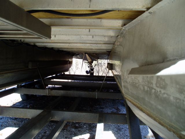

My u-bolts were too short for my trailer. I bought 2, 1/4" thick 1 1/2" wide by 12" long bands of steel at Ace and cut and drilled them to be able to drop 8, 7" long 1/2" bolts through, instead of using u-bolts.

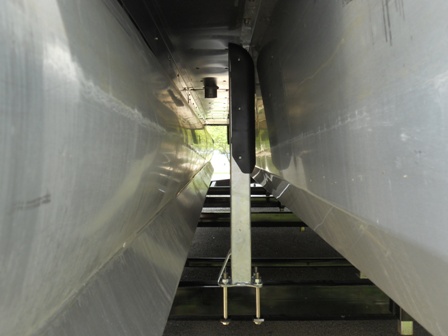

Their many types of gides around I have found this type to be the best.
- trailer back.JPG (232.56 KiB) Viewed 3359 times
Re: Pontoon trailer guides...
I like these the best that I have seen. Thinking about getting some like this made, just wondering if there is reason you dont have these mounted more to the back?MH Hawker wrote:Theirt many types of gides around I have found this type to be the best.

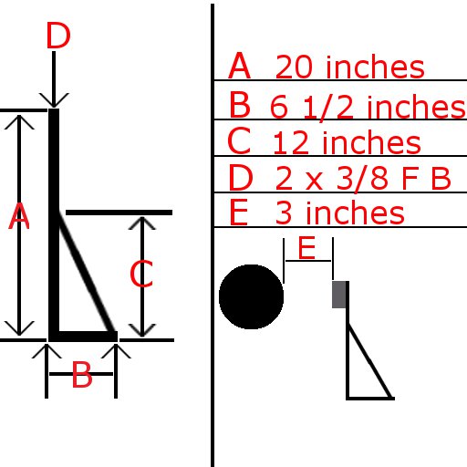

That part is under water and normally to deep to be of any real use. And this drawing may be of some help and the dementions may varie due to different toon OD`s but its a example.
