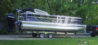

- Side2.jpg (12.87 KiB) Viewed 2403 times
