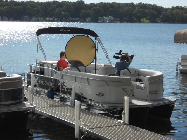

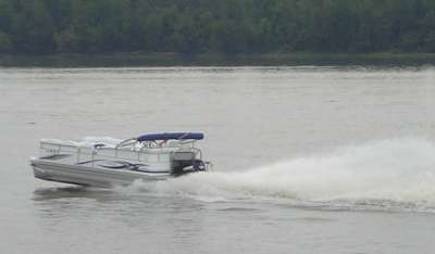

When we did the photo shoot for Manitou, the 23 foot Xplode ran a solid 52 with a 250 etec.
My 2007 ran 48, right out of the box. with the transom mods, 10 CMC hydraulic jack plate and streamlining the pontoons, with Manitou's blessings and guidance, we hit 62 running my 250 Etec and a 26 pitch Raker. But it was a wild ride, only the last foot of the center pontoon was in the water. And the bow flew wildly high with some props. It was all for testing purposes and fun! When I sold the boat, I returned it to stock, because I didn't want the new owner to injure himself or his passengers.
Its not hard to do, but costs alot to go fast! I had alittle over $4k in modifications, with machine shop costs, jackplate, I had props up the ass, custom bent and blueprinted. Its costly...And in un-expirienced hands, can cost more than $.
That said! I think there may be some stock Playcrafts out there with single 350's running close to 60. Contact Jim Dorsey at Playcraft if your serious. Very nice guy and won't steer ya wrong!

- Manitou filming me in the 23 Xplode
- manitoutrip 034.jpg (136.77 KiB) Viewed 5388 times
- My 2007 blasting by the photo boat around 57 mph, before the Custom Raker was made.
- Flyby3-100.jpg (7.46 KiB) Viewed 5388 times
