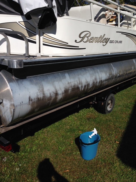

I need some help. Pulled my 22ft Pontoon out of the water for the season and purchase some ToonBrite cleaner to clean the pontoons. The jug says to dilute, spray on let sit and spray off. Well, it didn't go as planned...of course! It made the toons all blotchy and spotty and now Im at a loss for what to do! Can someone help?! Ive tried scrubbing and spraying and haven't got anywhere. Any advice and recommendations would be very appreciated!!

Maybe some of the guys with a lot of experience with Shark Hide (or maybe email Shark Hide with your picture) will chime in but something similar happened to me on my Bentley but I did a test spot and after I saw the results I quit. 2 years later when I traded in the Bentley, the spot was still there. It will fade a bit with time and exposure to the elements. What I think happened on mine is the scum (which I had cleaned off well - at least so I thought) kept the Toon Bright from penetrating. Then, the rest of the "splotches" appeared to be due to varying levels of oxidation (or whatever others want to call it).

The trick when cleaning the toons is to do one section at a time, with the tubes dry, work from the bottom up, and keep spraying it on until you have a nice even layer of foam. When the cleaner foams up and runs it makes streaks... So just keep applying until its uniform, then wash off good with water. It might take more than one treatment.. AC coil cleaner does the same thing if you run outta toonbright!

Find someone near you who polishes aluminum, or do it yourself, it takes a little time and will get you dirty, if you just went over them one time, try it again, when I rebuild mine I took it to a truck stop near me, had it acid washed there then took it to the polishers just behind them to do the bigest part of it, then we finished the insides and the engine pod.
So they can be cleaned, it just how far do you want to go with it.

Thanks for the info guys! I think the problem is that it's a 2008 and the pontoons have never been cleaned. When I bought it this spring it went right in the water so it's oxidized pretty good. We put on some rubbing compound and used a buffer, it's gonna work but with a lot of applications and a lot of elbow grease!

That is a major issue. The first look at your pics and I had the impression they had not been cleaned enough. Like the others said, even coats and NEVER let any cleaner dry on your logs. NEVER clean them in direct sun light or risk streakes. I've had toons that were so bad that 6-8 coats of straight mruatic acid wouldn't touch the deposits. The only onther choice at that point is a sander or buffer with some harsh compound. Good luck.
