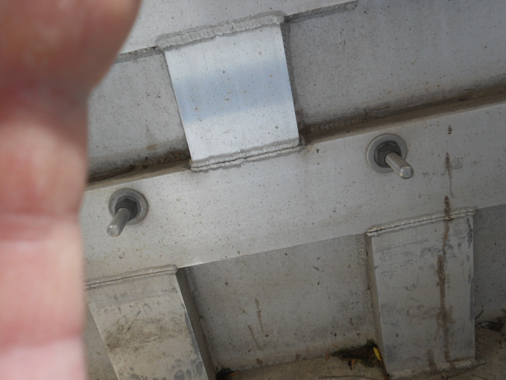

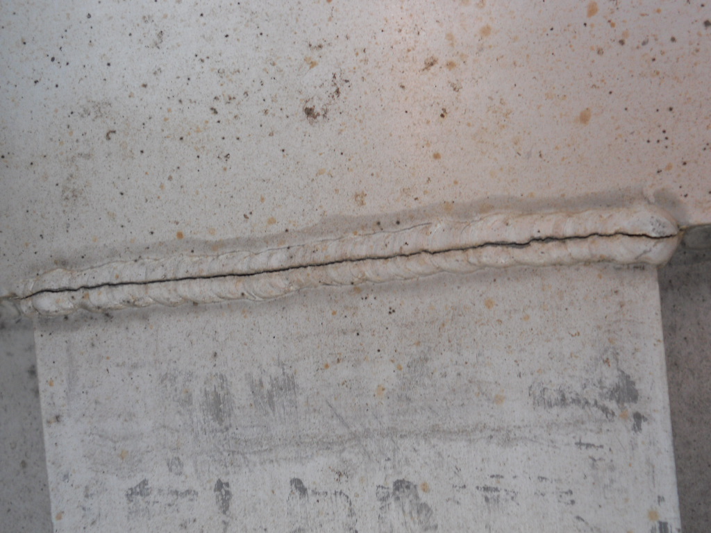

Re: Motor Support/Transom Saver?
Why to use one? To prevent this! This is my Premier's transom. Been there, done that. Not going through it again. Its on every time, close trips to the river and long trips to the Lake. Its on more than its off!
If you want this? Don't use one.
