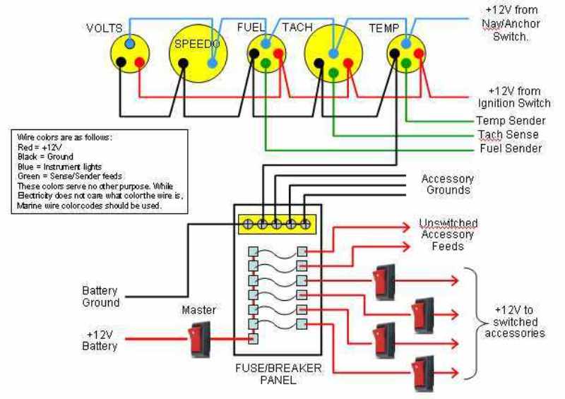

Do you all suggest using Pre-made wiring harness, or just wire as you go??
I have just ordered a book on marine/12V wiring systems. I am sure it will have its opinion in that area... just curious what y'all do.

#5 Post by curtiscapk » Fri Apr 10, 2015 10:38 am
these may help...

#6 Post by sharky300 » Fri Apr 10, 2015 2:26 pm
Awesome-Thanks!!!
That will help out a TON!!!
