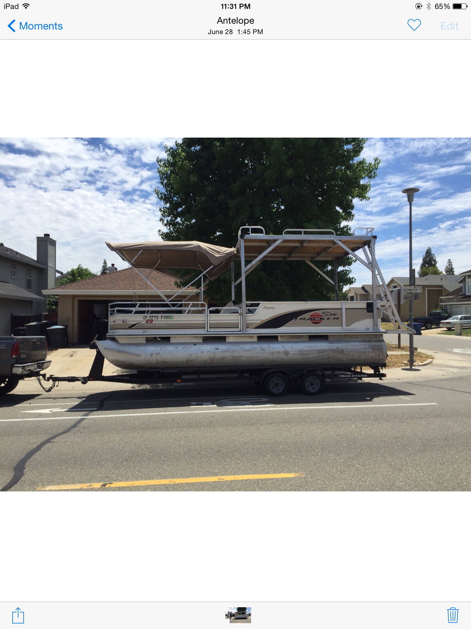

#8 Post by phat06 » Tue Jul 07, 2015 11:34 pm
It's not as difficult as it sounds, or looks. Simple frame from 2 inch aluminum channel structure and 1/2 inch treated wood platform. Entire frame with wood and carpet is only 315 lbs. build a 2 1/2 foot swim platform off of the rear of the boat for the ladder to get to the top. I built this 4 years ago and use the boat many times a year with no issues what so ever. I've had 6 adults up top at one time and it's very stable when anchored. No riders while boat is moving.
