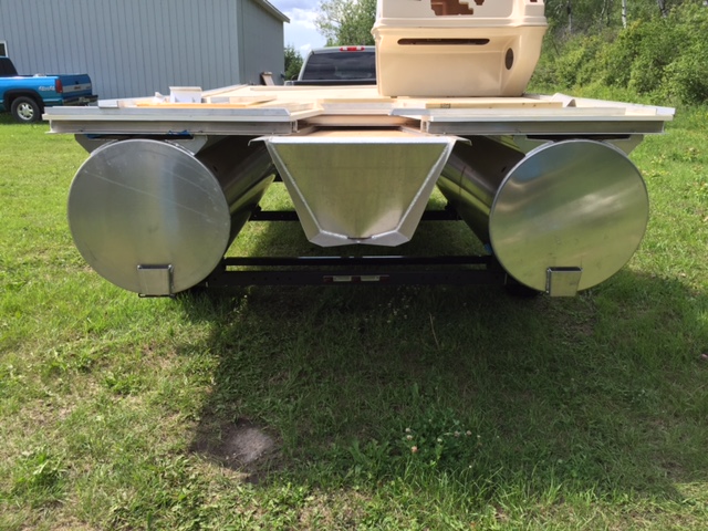

Could you post a picture of the rear of your set up?

As requested here is a pic of the back

I'm guessing you'll be fine with a 20" shaft. Most newer 2-log toon run a 25" tube, and while they do have some drop to the back of the transom they also have more riser on the tube then you do. Given the information in this post, I'm betting a 20" shaft 90HP on your boat will work fine (assuming your layout doesn't bias the weight to front too bad).
Check out the picture below. This toon has 25" tubes, a slight drop in the transom, but taller risers then your boat does. I had to drill another set of holes so we could get the motor UP HIGH ENOUGH to get the prop running clean.
Worst case if you get it in the water and it cavitates too much, you could always cut 2" or so out of the top of the transom and weld a cap on the top. That should give you plenty of adjustment, but I would try it as it first.

Thanks ToonGuy, I was under the impression that I had to measure the leg length like a mono hull - top of the transom to the bottom of the toons - to get the correct leg length. I will definitely try it with a smaller leg and see if it works.

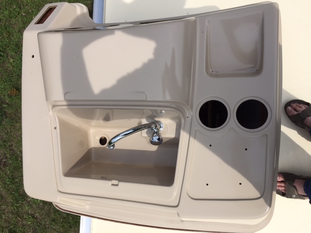

Thanks again ToonGuy, I have another question for you. Where does a person find parts for older consoles? I purchased the console in the attached picture from Great Lakes Skipper knowing that it would come as is. I didn't think it would be difficult to find the correct panels if I contacted Harris Kayot; I was wrong, Harris was unable to help me lol. Is there a company out there that sells replacement panels for boat consoles? The piece I have no idea what goes there is the large odd shaped hole to the left of the steering column. I am also trying to figure out what went on top in front of the cup holders (beside the sink in picture 2).
