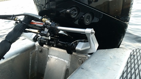

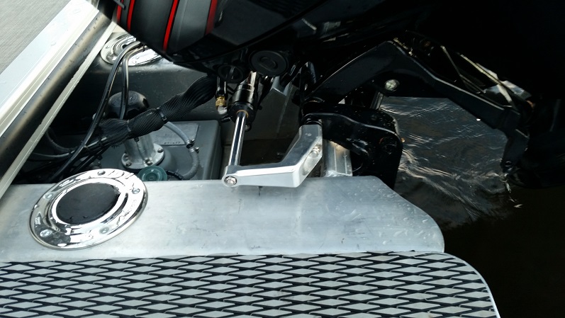

had time to finish the fabrication on the new pump arms today and install the newly designed hydraulics......dropped the motor to the last hole and still caveated. NOT HAPPY. time to contact Tracker cooperate. At least I was able to solve 1 issue, the motor will now tilt to remove the prop from the water for storage.
