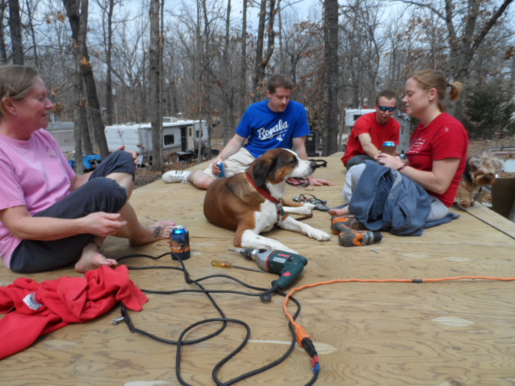

#8 Post by Barry » Sun Mar 20, 2016 4:18 pm
Well, we have a floor! The wood is all bolted down. The carpet is laying across the floor for a couple days till I get time to rent the 100 LB roller and glue it down.
