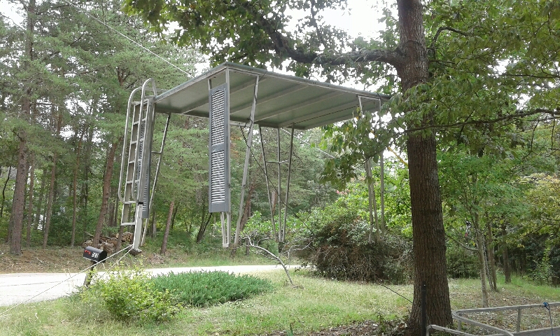

Im on lake Hartwell in Ga. The corp wont let me have a bigger dock. But they will let tie a boat to my dock. So that is my motivation. More dock/party space. I find me an ole double decker toon with blowup motor and drag it over to dock. Wife thought I was crazy. Blow up motor, seats falling apart, small trees growing on deck and you could fall thru deck in most places. It floats great and was very cheap. So I clean it up. Throw away seats. Take motor and transom off. That was this past spring. Now the fun starts. I borrow a friends trailer. Since it is just me working on I have to get a little creative at times. Back it under a tree. Use a come along to left upper deck off and start the rebuild.
