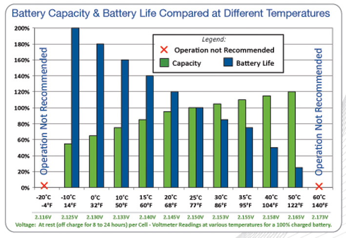

[quote="C_M_25"]Your batteries last the winter doing that? Figured the cold would zap them.[/quote]
Absolutely.... As long as they are in good shape and are fully charged as well as disconnected to prevent ANY minute drain...
While cold weather indeed freeze dead battery it will not freeze a fully charged battery. Also to clear up any misconceptions while cold does reduce a battery's capacity (think small) it actually extends their life more so than being kept in a hot location or climate...

- Temperature%20vs%20storage%20capacity%20and%20lifespan.jpg (116.86 KiB) Viewed 5517 times
