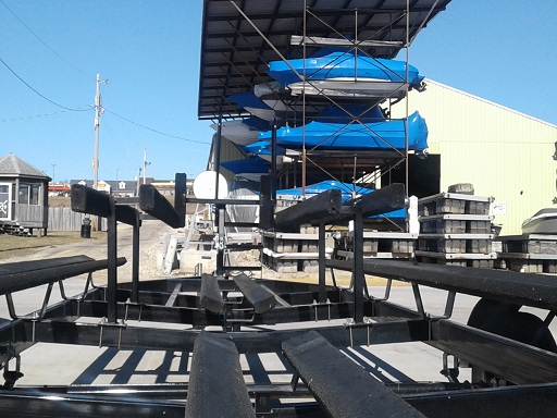

I used 2 pairs of those on my Premiers trailers. Worked good, except for in real strong side currents. The boat would want to get caught between them. So I took an afternoon last spring and welded these up in my boatshop for the Manitou trailer I bought. I used 1/4" by 4 for the base where the U bolts fit to the trailer. 1/4 X 2" L stock for the risers, 1/4X 1 1/2" for the inside guides extensions. I had about 50 bucks into everything. Most costly was the carpet. They work in the strongest currents and winds. And kept the boat real steady all the way up to the cradle.

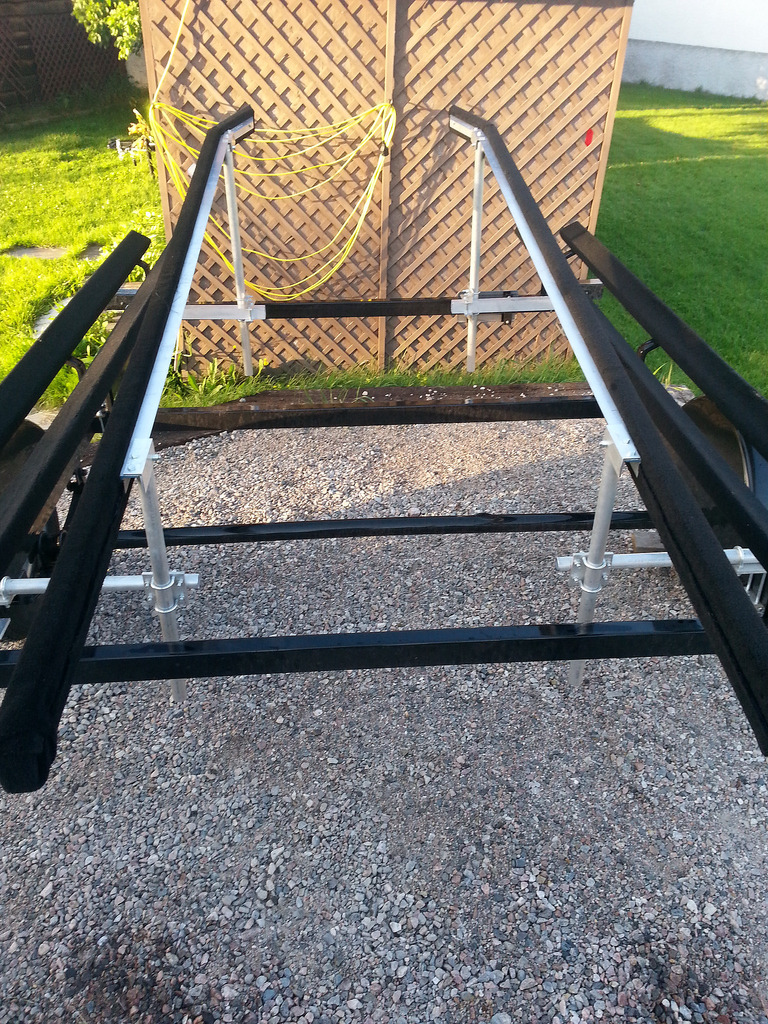

https://4c-innovations.com/
I bought and installed the guides from these people. I really like them.
Not the cheapest but really do help with cross winds.
Picture on their website of a trailer for tritoon is mine.

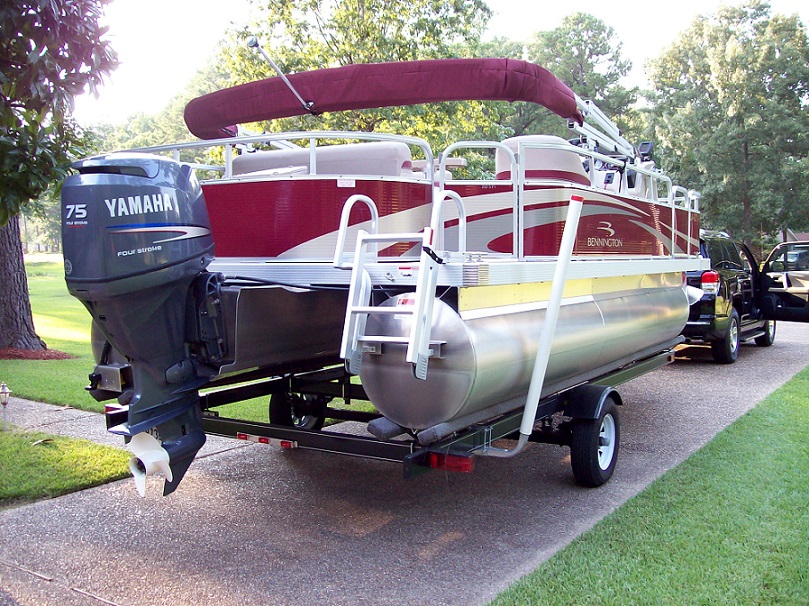

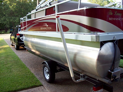

I made my own guides out of 2" PVC and it worked really well. My wife guides the boat on with ease and it only cost about $80 bucks total.
viewtopic.php?f=2&t=24105

I second on 4 C have system on mine. Best investment

JNorris79- My boat is a tritoon as well. It works, I promise. I realize you don't see a center bunk on my trailer but that's they way I got it. You should be able to do the same anyway. It's actually doing the same job as the metal rails w/ wood bunks picture above it's just made out of PVC and uses stainless hose clamps to hold it to the trailer.

I agree with BuDoff. We installed the guides from 4cinnovations and love them. Have never failed to load the toon the first try. Easy Pease. Best 500.00 we ever spent. If our toon wasn't skinned we would have bought the latch system too. 4cinnovations.com. not an employee. Just a very happy customer. Free shipping too

I just bought the 4c-innovations guide system and I'm putting it on my trailer tomorrow, for the first test on Sunday. I'll check back in with the review from windy Kansas.
