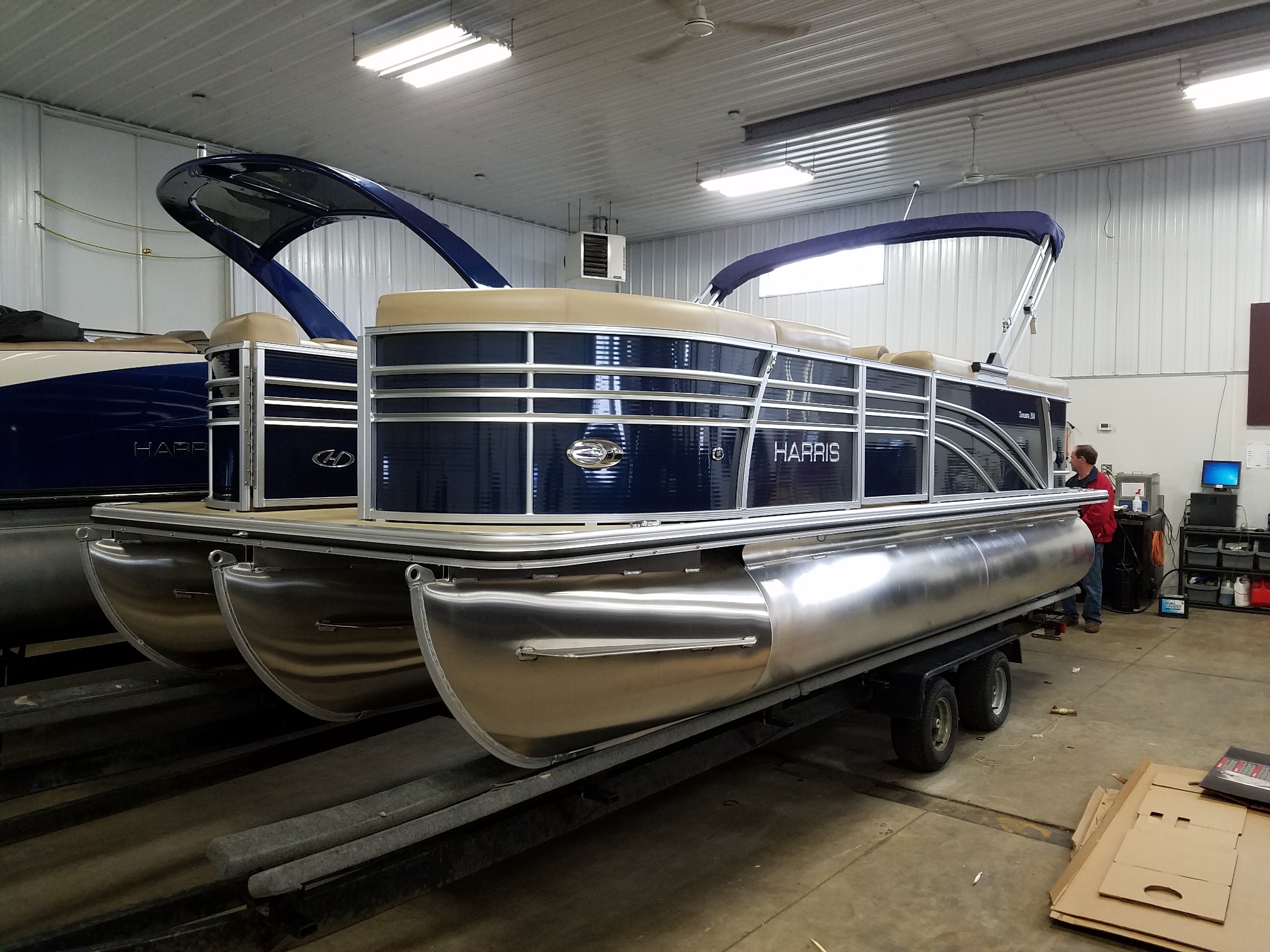

I am getting mine delivered on May 2nd can't wait
My dealer is not a big believer in shark hide, not sure if i should do it
The boat will be sitting in the dealers lot until it is delivered, I was thinking of going over there and applying it after they close or on a Sunday. if they do it, it will be big bucks.
If i lived in Alabama, it would be in the water now, but up here, we can still freeze, also i have to have a new lift installed
