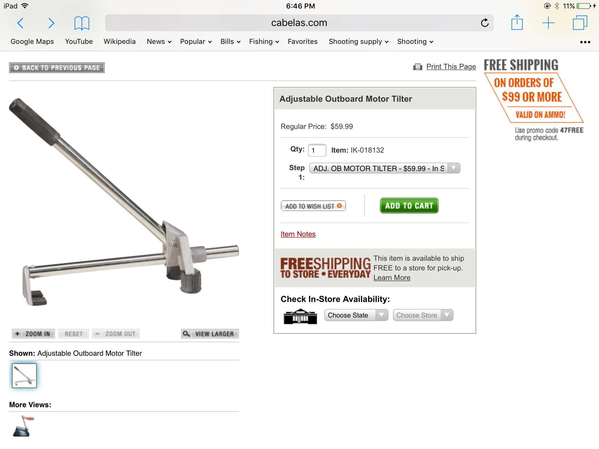

I have used this in the past when I didn't have tilt or trim
